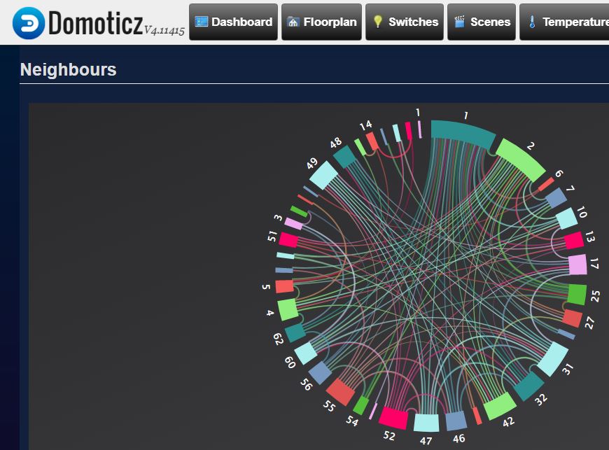

Post by sincze »
mm148881 wrote: Tuesday 05 November 2019 10:58 I have three of the same model (the new one). Two works pretty well, one of them after two months loses connection at just 5 meters (and a concrete wall) from the controller, the others don't. I guess that's not high quality stuff.
That is really annoying indeed.
I had a Fibaro with the same issue. So Well not limited to NEO :lol:
What I needed to do was:
- I pair a Secure Node near the Base Station (same room).
- After all properties have been detected ( I give it some time ) I unplug it and move it to the final destination
- Mesh network takes care of the rest. I do mention that I have a lot of plugs so the mesh is pretty ok.
- Incidentally I instruct the nodes to - find their neighbor - but due to the extensive network I have now this has not been done since 2016.
