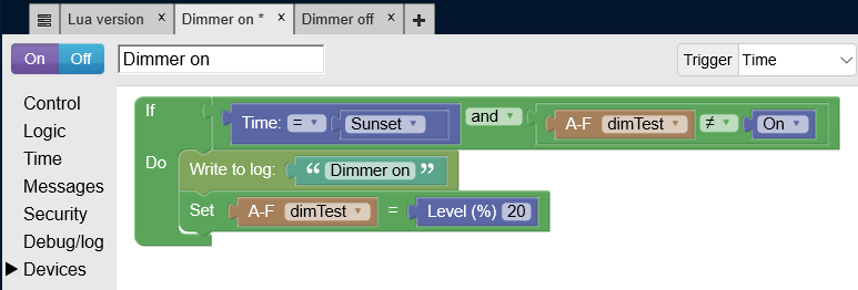

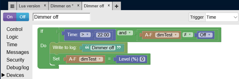

Re: Time Triggered Blockly does not work (LED Off - Xiaomi Gateway v2)
misfit wrote: Monday 04 November 2019 9:02 Yes i set the trigger to 'time':
Try with this, State can be something else then 'On' or 'Off'
Changing level to > 0% does switch the devce On and changing level to 0% does switch the device to Off.
dimmer on.png (28.33 KiB) Viewed 718 times
dimmer off.png (28.59 KiB) Viewed 718 times

waaren wrote: Monday 04 November 2019 9:52
That's working, thank you. Any idea how to change the LED color using blockly?
