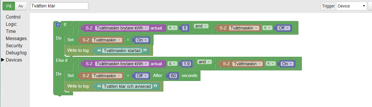

So, I have 3 scripts that tells me when dishwasher, washing machine and tumble dryer is finished. 2 out of 3 works perfect, but I can't for the life of me get the third one working. "Tvättmaskin" and "Torktumlare" are virtual switches used for notification and visual verification if the machines are on or not.

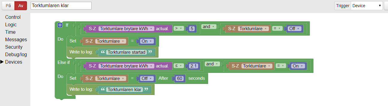

Attached are examples of 2 of the scripts. Tvättmaskin (washing machine) works fine. Torktumlare (tumble dryer) keeps "looping" on me. When the watt usage drops below 2.1 W, the virtual switch "Torktumlare" starts again, although the script states that it shouldn't unless watt usage is > 5W. So it goes on, and then immediately off again which results in a ridiculous amount of notifications. I have disabled the script for now.
Attachents are the blockly scripts and the datatable for watt usage.
This one works.
This one works.
This one doesn't although it is identical to the other one.

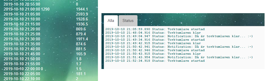

Data table for the switch that the dryer is attached to and log status for the script.

This happens mostly when you also switch on the same switch in another script, or in settings of the switch itself. Please double check your other scripts and the properties of the tumble dryer switch.

Thank you, knielen, but as far as I can see, there is nothing in other scripts or the switch itself that differs from for example the washing machine. Hmm, don't know how I will go about this!

What about the values of the KWh? Maybe these make the triggers go strange? You could have a look at the KWh log?
