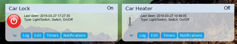

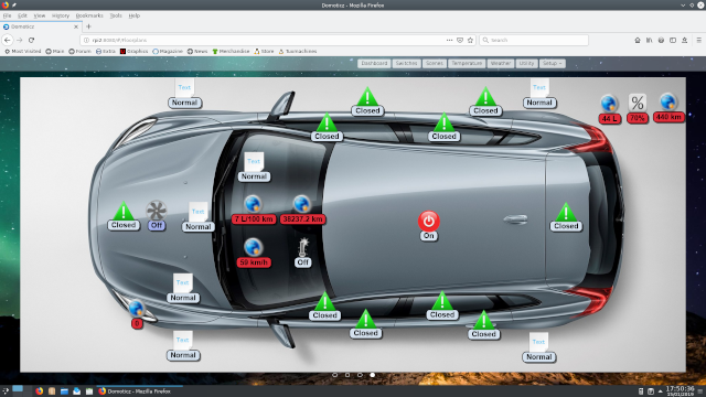

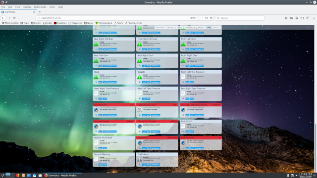

If I search this forum for "Connected Cars" and in particular Volvo I don't find any post. While other Home Automation projects, like Home Assistant and OpenHAB have implemented this functionality, I thought it should be possible in Domoticz as well.
Of course it depends on the car and whether an API is available or not.
For Volvo I found a python script at Github: https://github.com/molobrakos/volvooncall and I decided to implement this.
For me using MQTT was the right way to go and as soon as you have pushed the available sensors to your MQTT broker, you can use Node-Red to push it further to Domoticz. You can even create your own "Car" plan.
I wonder if anyone has also done such an implementation in Domoticz and will share his or here useful ideas?
Some screenshots are attached.

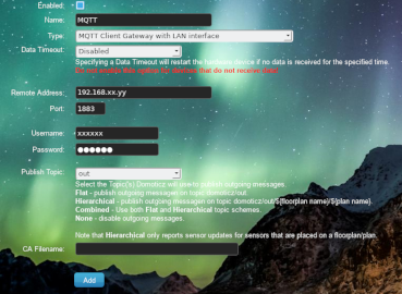

2. Install in Domoticz the MQTT Client Gateway with LAN interface and fill in the required fields
See:
MQTT Domoticz.png (134.46 KiB) Viewed 10095 times
Check that you can communicate between Domoticz and the MQTT Broker.
Subscribe with any client to domoticz/out and you will see various messages passing.

The next step is to install the MQTT Client Gateway with LAN interface (see above)
Check with your client that you can subscribe to domoticz/out.
You will see a lot of messages from Domoticz.
If this all works you can start to install NodeJS and Node-Red. See the links above.
