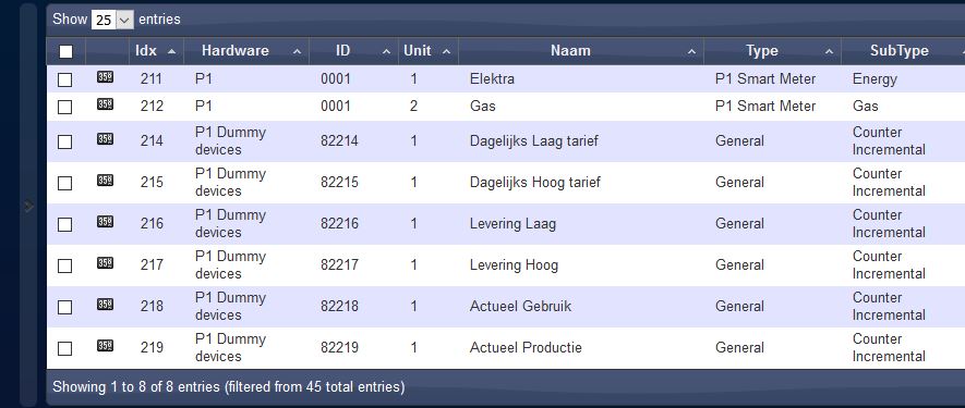

Thx for the script, took me a while to implement it because I am not familiar with programming etc.
Finally found out I used the wrong kind of Virtual Censor.
But never to old to learn.
1 Question remains ... Now i got about 6 "Counters"low, high"(dag, Nacht) etc.
I really would like to add those 2 togheter something like :
Total Usage = Low Usage + High Usage
Total Delivery = Low Del. + High Del.
I am using the ScriptVersion = '0.1.8'
If this is basic knowledge... pls redirect me.
thx in advance.

Hcroij wrote: Wednesday 30 October 2019 16:42 I really would like to add those 2 togheter something like :
There are quite a number of variations of this script flying around on this forum even with the same version number. So to ensure that a solution for this will work for your script, please share the script that you use now. Also helpful if you tell the device names / -types / -subtypes of the devices to receive the Total usage and Total delivery.

Re: Script to parse Electricity form P1 Smart Meter reading
Hcroij wrote: Thursday 31 October 2019 10:45 As you can see i am not very familiar with the forum,
You can copy / paste text in your post. Select it and press the </> button at the top of the edit window. That will place the text / code in a code window.
dzVents script to Parse P1 Smart Meter Electricity value into separate Meter Readings.
You will have to add two virtual (incremental counter) devices like the ones you already added and replace the xxx in below script with the idx or 'names' of these new devices and copy / paste this script to replace your current script.
That should do it

Hcroij
Posts: 29
Joined: Sunday 27 November 2016 16:36
Post by Hcroij »
Thank you for the fast response,
Working like a charm.
