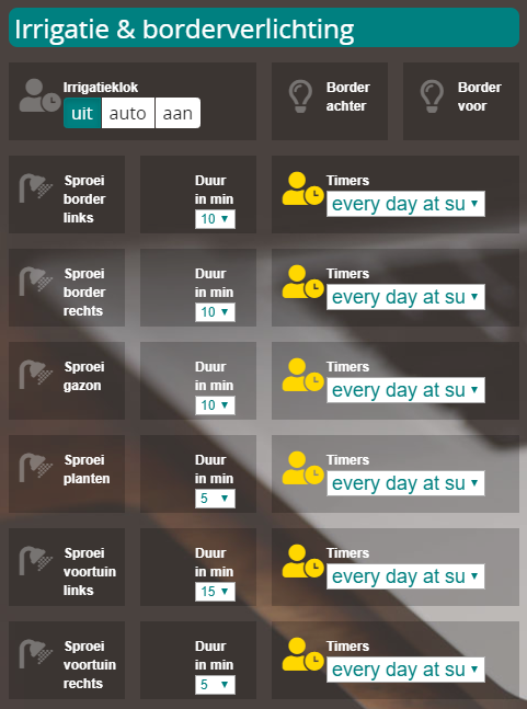

Is this what you want? (i have 6 irrigation zones, each zone has his own timers)
Jablotron connection, Ikea

pvklink wrote: Wednesday 23 October 2019 22:25 Is this what you want? (i have 6 irrigation zones, each zone has his own timers)
Can you share a solution? It's interesting.
