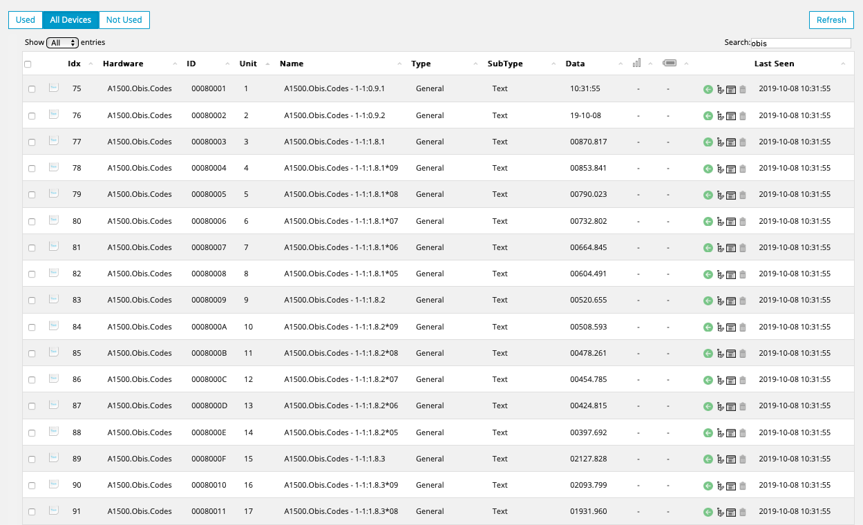

Plugin is design as a universal value extractor from a meters using OBIS codes.
https://github.com/MFxMF/Domoticz-OBIS-Codes-Extractor
Value are save in the domoticz as a TEXT devices.
You have to do your own script for present data as a chart using the dummy devices.
Plugin should work with any Meter (electric, heat, gas, water), supporting OBIS codes via RS485 or RS232
Tested on the Energy Meter Elster A1500
