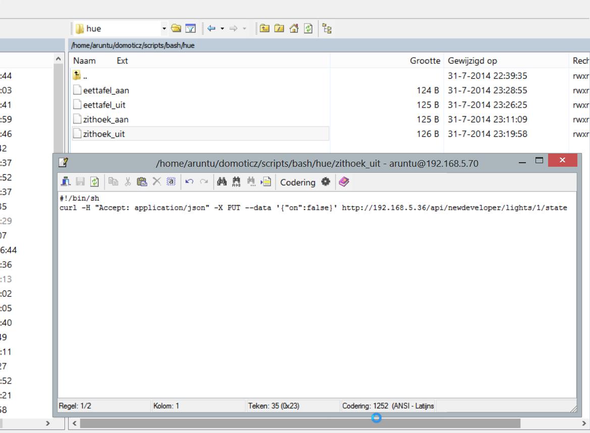

Probably rather than create a Lua script if all you want to do is execute an operating system command then create some simple Bash scripts and then call them from the On and the Off actions of a button.
So create a directly /home/pi/domoticz/scripts/bash to put your scripts in.
Create a file called something, say bashscript, which contains:
#!/bin/sh
curl -H "Accept: application/json" -X POST --data '{"devicetype":"test user","username":"newdeveloper"}' http://<bridge ip address>/api
So on the command line on your Raspberry Pi:
mkdir /home/pi/domoticz/scripts/bash
cd /home/pi/domoticz/scripts/bash
nano bashscript
Type in the bashscript contents above modifying the curl statement with your ip addresses etc, then CTRL-O to save the file and CTRL-X to exit nano. Finally, make the file executable:
sudo chmod +x bashscript

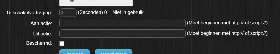

Then add script://home/pi/domoticz/scripts/bash/bashscript in the On action box and save the switch.

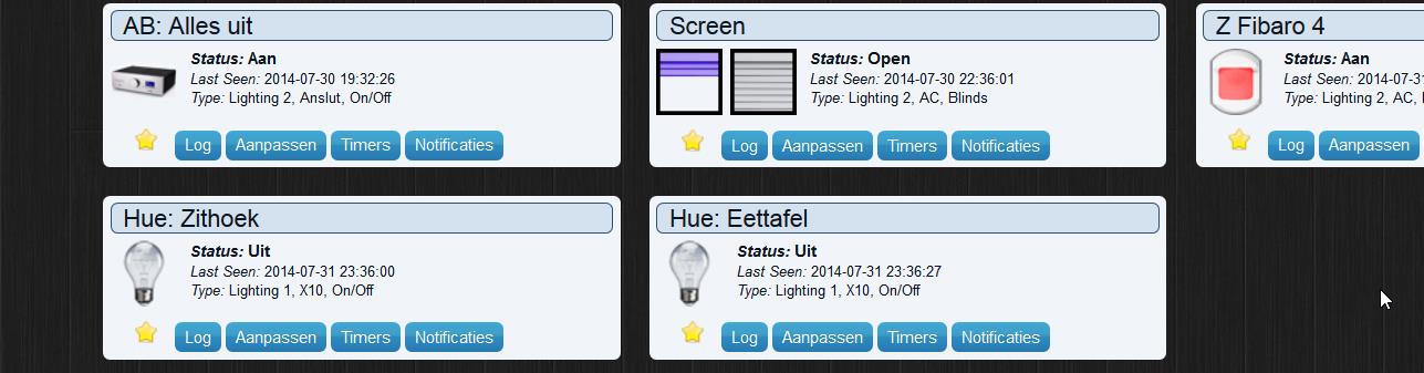

Tomorrow i will make the management happy with a switch that Hue turn on and off.
Better yet: the Hue above the seating area with mood light on.
The Hue over the dining table, fiercely.
Weird ...
I've made ​​a bash for each circuit, is this correct?
And is it true that I cannot make a slave / master from a switch with a script? [ a one that is working correct ... ]
My next step is to see if a hue.
Now there is a difference between switching the app on the tablet, and the status of domoticz.
Is to live with, but if anyone has a script to check a switch ..

Just on, with the last settings of the Hue it selfs:
curl -H "Accept: application/json" -X PUT --data '{"on":true}' http://192.168.5.36/api/newdeveloper/lights/2/state

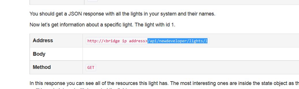

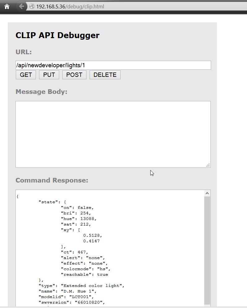

The color data i read from the Api tool:
I just set the color i want with the app on my phone, then wait a minut, and read the data:

This was the hard part.
You can use Textwrangler to edit your files directly on the rpi.
Open TextWrangler (download first), go to File menu, select Open from FTP/SFTP server.
Fill in server ip address, loginname (pi) and password (raspberry), and don't forget to select SFTP. (SFTP uses the SSH protocol (..) to transfer data.)
Now you can go to the bash directory and you'll find your previously created file. From here you can edit it (to switch off) and save it under a new name.
You'll still have to use Terminal and ssh connection to make the files executable, but editing is lot easier now.
