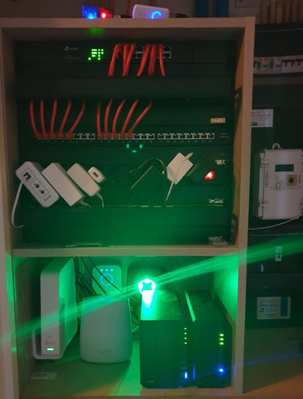

Goodmorning..
I was using Domoticz on a Rpi3b+ for a view years, but had soms trouble with stability... so at this moment i run Domoticz on my Synology DS118 and so far no stability problems at all!!
It runst Zigate (20 bulbs Philips Hue) / Zwave (6 sensors) / RFXCom(5 dimmer/scwitches) / Sonos-node-httpi-api (on Pm2 server) and a lot of Dzvents scripts...(Toon for example) CPU is never more then 3%!

awesome setup you have :-)
