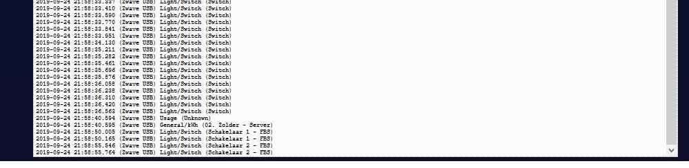

Also I noticed, (see picture with log) when I press the switch, the sensor gives 2 reactions. No idea why.

I really don't know Blockly this well but perhaps try to create a dummy "FakeSwitch"?
You try to toggle the same switch that is in the condition.

... or just a little time delay so that the Pulse is not causing a loop?

Hi Peterus,
Thanks for your response.
the time delay, was something I thought of myself, but all it did was a time delay in the loop.
So not the result I hoped for.
How could a dummy switch be of help?

Thats why i like LUA more, it has options like:
if (devicechanged['name-of-your-switch']) then
or
if (devicechanged['name-of-your-switch']) == 'Off' then
You get the idea. The script will only react on the devicechange
or

Hi Jimmy,
scripting, whether it is in C, in Java or in Lua, doesn't come easily to me.
So that is why I try to avoid it much as I can.
However, I am thinking about writing it in Lua indeed, Blockly just is not going to work.
