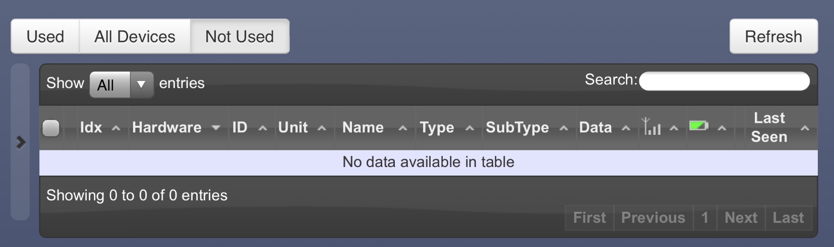

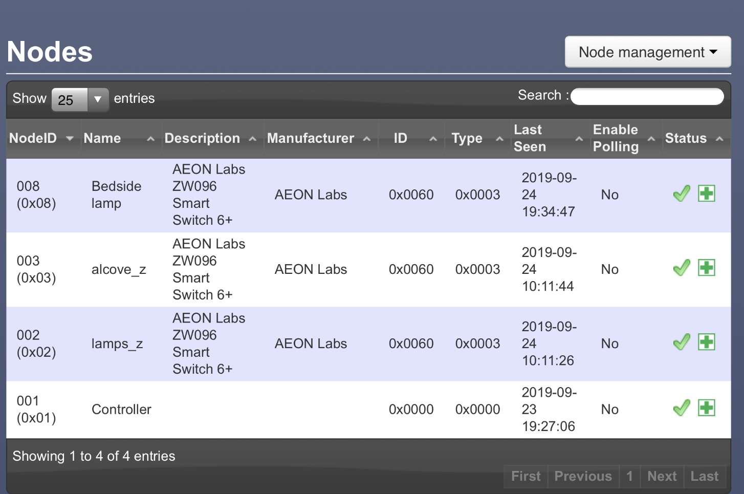

The nodes added didn’t go to domoticz devices - that was my problem.
So they were being added to “nodes” under the openzwave:
But when you went to setup > devices - the new nodes were not under devices:
To get domoticz to “see” the new node as an unused device.
You had to go to openzwave control panel from the drop down in openzwave setup - and change the device state.
