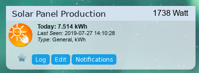

I would suggest not to use "Usage", as a virtual device, but to use Electric (Instant+Counter) and let Domoticz do the calculation.
So send the Real-Time value and you will get something, like below:
Screenshot_solar production sensor.png (50.33 KiB) Viewed 182 times
If this is what you want?
