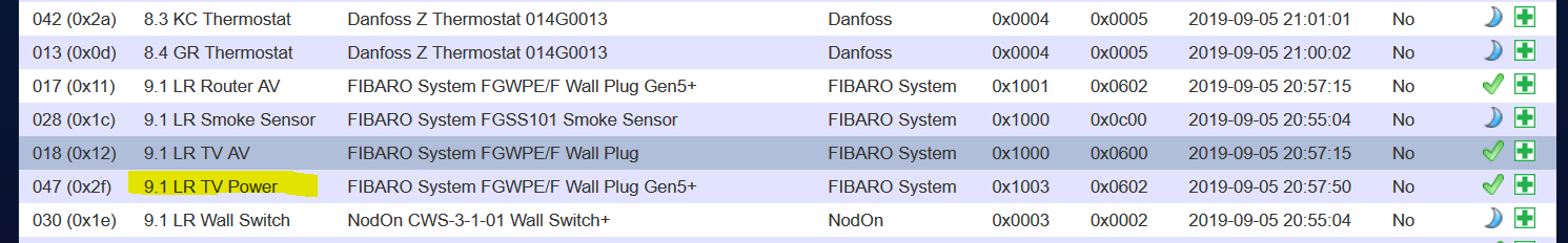

For example: how does zwave node 047 (0x2f) 9.1 LR TV Power
some zwave nodes.PNG (44.91 KiB) Viewed 471 times

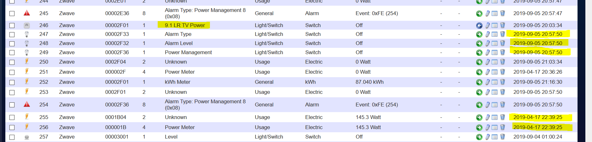

relates to device 246 Zwave 00002F01 91. LR TV Power ?
some devicesPNG.PNG (135.47 KiB) Viewed 471 times
I would like to find out which devices belong to the same node.

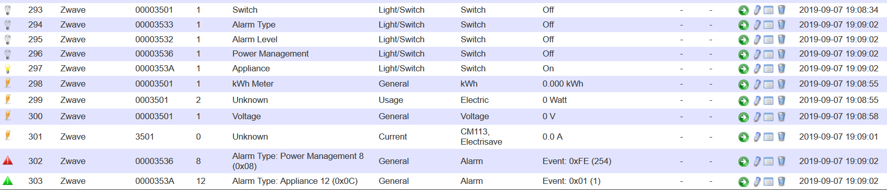

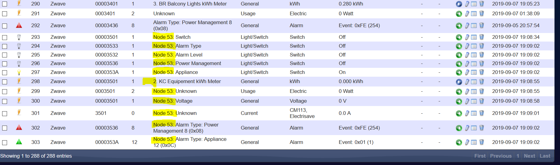

First screenshot after the new node:
Node 53 Qubino Smart Plug 16A.png (103.35 KiB) Viewed 449 times
Second screenshot after renaming and adding one device to the Lights webpage:
Node 53 Qubino Smart Plug 16A - renamed.png (151.25 KiB) Viewed 449 times
