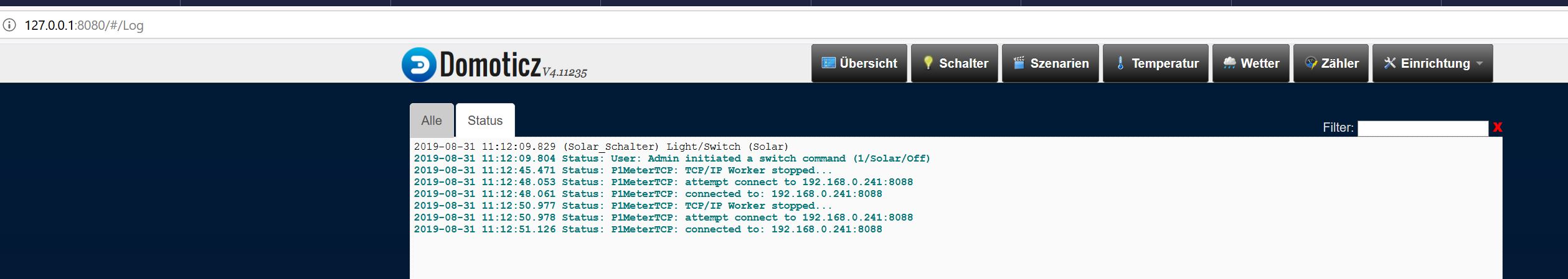

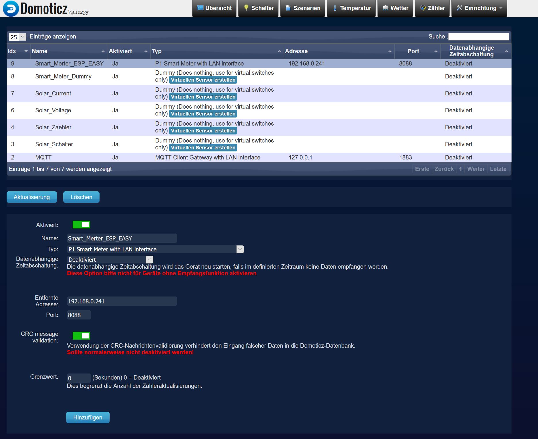

I choose in category device 1 ✔ Communication - P1 Wifi Gateway
I choose in controller ✔ Domoticz HTTP 192.168.0.240 8080
Now to the problem

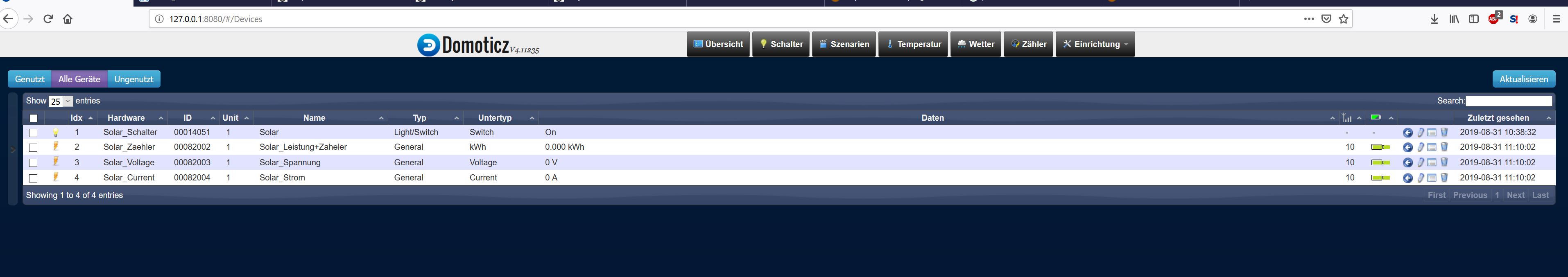

i am not able to get the Smart meter shown up on the device list. I am only able to set it up on the hardware window and i don´t know why :(
On the logscreen is the conection show up as "conneced". Attached screenshots from i hope all relevant configurations!

The sonoff Pow is working fine over mqtt !
But i want to use a the P1 Smart Meter with Lan interface and i don t know what i have configure in domoticz.
