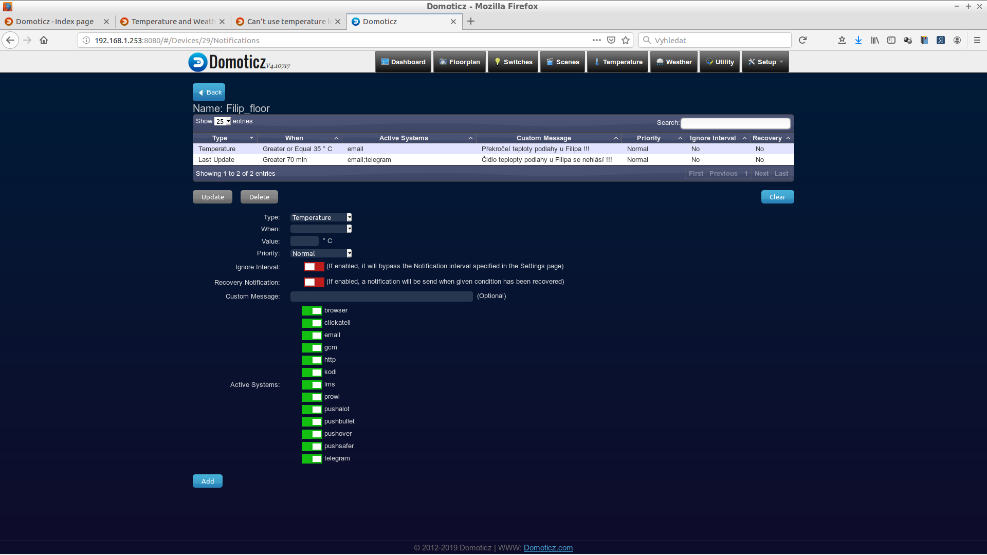

Why this complicated way???
Simply set allow e-mail notification and in device notification tab set conditions:

Re: Can't use temperature level of sensor in dzvents
kimot wrote: Wednesday 21 August 2019 22:02 Why this complicated way???
Because the OP clearly looked for the right dzVents syntax.
