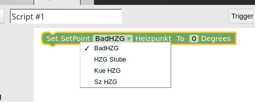

Trying to understand, why the blockly setpoint field only show 4 setpoint of these existing ones.
209 Aeotech C5 0001901 1 Kue HZG Heizpunkt Thermostat SetPoint 10.0 -
210 Aeotech C5 000190B 1 Kue HZG Heizpunkt Eco Thermostat SetPoint 17.0 - -
211 Aeotech C5 0001907 1 Kue HZG Furnace Thermostat SetPoint 0.0 - -
1960 Aeotech C5 0002301 1 BadHZG Heizpunkt Thermostat SetPoint 10.0 - -
1961 Aeotech C5 000230B 1 BadHZG Heizpunkt Eco Thermostat SetPoint 18.0 - -
1962 Aeotech C5 0002307 1 BadHZG Furnace Thermostat SetPoint 0.0 - -
2035 Aeotech C5 0002E01 1 HZG Stube Heizpunkt Thermostat SetPoint 10.0 -
2036 Aeotech C5 0002E0B 1 HZG Stube Heizpunkt Eco Thermostat SetPoint 8.0 -
2037 Aeotech C5 0002E07 1 HZG Stube Furnace Thermostat SetPoint 0.0 - -
2046 Aeotech C5 0002F01 1 Sz HZG Heizpunkt Thermostat SetPoint 10.0 -
2047 Aeotech C5 0002F0B 1 Sz HZG Heizpunkt Eco Thermostat SetPoint 15.0 - -
2048 Aeotech C5 0002F07 1 Sz HZG Furnace Thermostat SetPoint 0.0 - -
The shown ones list a battery symbol in the devices view, can the other be added by config?
