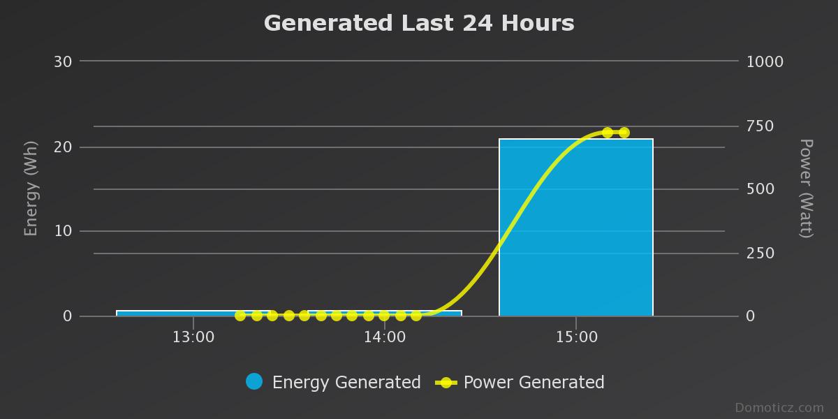

Thanks hoping to get this to work though (steep learning curve for me), got the first 120 lines working now, don't ask me how. but am now stuck at 121 in function getSessionID
Error: EventSystem: in anything: [string "-- Created by Raymond Wiertz..."]:121: bad argument #1 to 'sub' (string expected, got nil)
Errors are quite vague in my opinion, as in not clear as what to do to fix it.
Peter2807
- Posts: 8
- Joined: Tuesday 30 July 2019 23:01
Re: GoodWe Solar: get data from the new semsportal (lua script)
Lines 116 and 117 where commented out for some reason. no more errors but no data showing either. will continue to troubleshoot.Peter2807 wrote: Wednesday 31 July 2019 16:00 Thanks hoping to get this to work though (steep learning curve for me), got the first 120 lines working now, don't ask me how. but am now stuck at 121 in function getSessionID

Sincze, I downloaded and modified the script, deleted old sensors and created new ones just to be sure. No errors or warnings when executing the script however no data seems to be coming in, also nothing in the log indicating anything is running besides what was already running. Will investigate over the weekend. Thanks for now.sincze wrote: Thursday 01 August 2019 18:21Hi Peter.Peter2807 wrote: Wednesday 31 July 2019 23:42 Sincze, what pre-requisites besides php 7 are needed when running this script on a Synology? I''m getting a few warnings:
Please try latest version here: https://github.com/sincze/Domoticz/blob ... Goodwe.php

Peter2807
- Posts: 8
Cookie is writable, and changes every few minutes (new timestamp and inside a see a new session-ID)sincze wrote: Friday 02 August 2019 8:00 Please turn Debug On.Do it will show you the results in between is the cookie created?
Does it say cookie writable?
If not... You will see no data indeed and no errors.
Now trying to figure out how and where to turn on debugging
Been looking at the Pass2PhP sub-forum also, sofar not helpful looking in the wrong topics most likely.

Changing lg to echo got me this:
Goodwe JSON results Found! Goodwe: 433 W, today: 2.6 kWh, Inverter total: 10352 kwH for domoticz: 433;10352000 (udevice) | 16 => 0,433;10352000
So it looks as the script is working, still no nice graph in Domoticz
Port 8080 is what needed to be changed to 8084, so finally I'm seeing something on my screen (to bad not much sun today)
Next thing on the nice to have list is a way to import all the old data (4 years) to be displayed. I know the data is available just not how to get it.
Sincze bedankt. (ie thanks for those not speaking dutch)
- generated-last-24-hours.jpeg (43.1 KiB) Viewed 4416 times

Excellent what 1 port change can doPeter2807 wrote: Saturday 03 August 2019 15:26 Changing lg to echo got me this:
Change echo back to lg and it will show the log in Domoticz.
Bedankt voor het testen van het script
