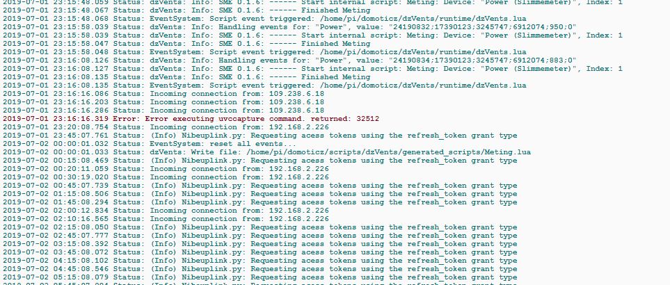

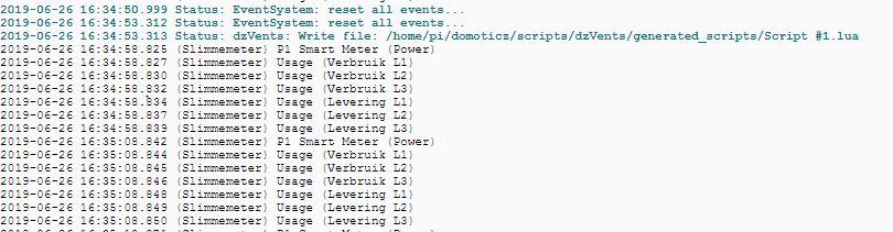

i have made a script that run's for several days en then stops running. When ik make another simpel script it won't run either.
When i start an blockly script that works.
In de log file you can see DzVents in writing the file, but nothing more
a reboot off te raspberry has no effect
- Knipsel.JPG (55.74 KiB) Viewed 4789 times

No effect, it won't run any script
is their a possibility (is use persistent data) that a buffer or what so ever runs out of capacitety?

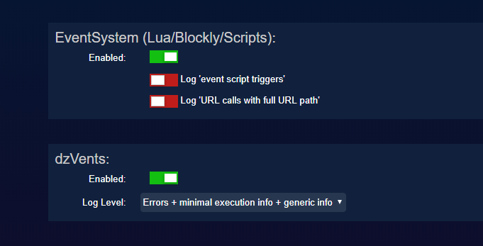

where can i check that the evenSystem en DzVent are both still activated?

[Setup] [system] [other]StefanWouters wrote: Wednesday 26 June 2019 18:39 nothing changed

DzVents was not enabled.....??? After turning it on, the script runs again (off course)
When DzVents crashes, will the crash disable DzVEnts??
Also activated the logging, so see wat happens the next 24 hours

DZvents stopt running after a fault. (see log)
in enabled DZVents again and the script runs again.
- Fout LOG.JPG (151.78 KiB) Viewed 4696 times
- waaren
- Posts: 6028
Re: DzVents doesn't run scripts
Please share your code / logs not as an image but between code tags </> ThanksStefanWouters wrote: Tuesday 02 July 2019 16:32 Hello Waaren,
I don't see anything here that would lead me to a dzVents issue. Still see the problem with a camera snapshot and I also see some stuff about nibe from which I tought it is not working and supported since 2018.
Can you deactivate that one in cron or is it still functional for you ?
StefanWouters
- Posts: 14
- Joined: Tuesday 18 June 2019 17:07
There are no camera's connected at the raspberry. Nibe is still functional.....
After the camera error, DZVents was disabled
