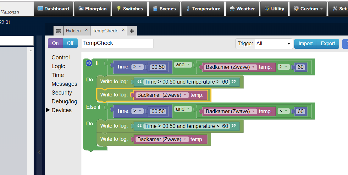

First I tried numbers:
Then I tried strings:
But in both cases the temperature is apparently simultaneously above and below 25ºC!
Only thing I haven't tried yet is compare to another sensor, but that'd be silly!

FearNaBoinne wrote: Sunday 07 July 2019 20:53 First I tried numbers:
Number should work. Suggest to first test without time and with just a logmessage. If that works add time condition and last step is to add message to notification subsystem.

waaren wrote: Sunday 07 July 2019 21:18
Without the time I have to wait for it to change, which happens once a day at most, not a valid solution...
Log or notification makes no difference.
Number should work.
As you can see, the system *does* see the correct value (17, {{temperaturedevice[360]}}=="Max Today"), but comparing it to a value doesn't work.

FearNaBoinne wrote: Sunday 07 July 2019 22:52
Just tested and with a differently placed time condition the Blockly solution works.
temp check Blockly
temp check Blockly
2019-07-08 00:57:00.496  Status: Time > 00:50 and temperature <  60  -- Time triggered
2019-07-08 00:57:00.497  Status: 21.4;45;1
2019-07-08 00:57:38.411  (Aeotec  Zwave stick) Temp + Humidity (Badkamer (Zwave)) -- device triggered
2019-07-08 00:57:38.696  Status: Time > 00:50 and temperature <  60
2019-07-08 00:57:38.696  Status: 21.4;45;1
2019-07-08 00:58:00.528  Status: Time > 00:50 and temperature <  60     -- time triggered
2019-07-08 00:58:00.528  Status: 21.4;45;1
I'll redid this in dzVents, because I really do not want to waste more time on this, when I can get this working in dzVents in 2-3 minutes!
Fully agree but for some domoticz users without any previous programming experience, the learning curve for Lua / dzVents / PHP / Python might scare them a bit.

waaren wrote: Monday 08 July 2019 1:07 Just tested and with a differently placed time condition the Blockly solution works.
I'll try this, just for testing, but the other way *should* work as well!

FearNaBoinne wrote: Monday 08 July 2019 8:34 That's why I think it is a great concept, and why I keep trying it... mostly unsuccesfully...
Quick update: Yes, the other way works for me as well... But nested IFs should work as well, esp. as it reduces the number of tests*... It looks that's where it broke... It just executed everything inside the outer IF, without taking the inner IF in to consideration...
*) In my version it only needs to do the time check, and only if it is the right time will it retrieve the temperature and do those comparisons... In the working version, it always has to check the time twice and always has to retrieve and check the temperature as well.

FearNaBoinne wrote: Monday 08 July 2019 8:41 ... But nested IFs should work as well, esp. as it reduces the number of tests*...
This remark triggered my memory. There are quite a number of posts on this forum that nested if's in Blockly does not seem to work. If you search for nested Blockly in the search window, you will find >= 57 posts

waaren wrote: Monday 08 July 2019 11:41
Sounds like a bug that needs to be fixed! ;)
