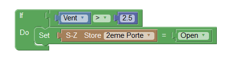

Hi, I have a very simple need ans also simple to understand.
When there is too much wind => I want the blinds go up to not be damaged.
I try this event: If the wind is stronger than 2.5 m / s then up blinds
=> but it does not work

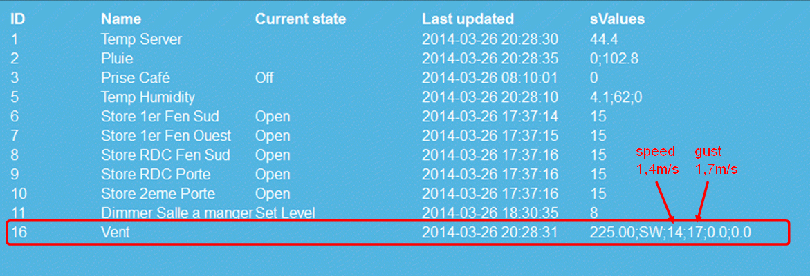

But it seems that my device "Vent" (wind) does not give a value but a string
with 6 values separated by semicolon (;) Questions:
1) Is it possible to recover only the value "speed" of this device "Vent" ?
2) Is it possible with a LUA script to create objects (virtual) that can be found in "Blockly" ?
Thanks.

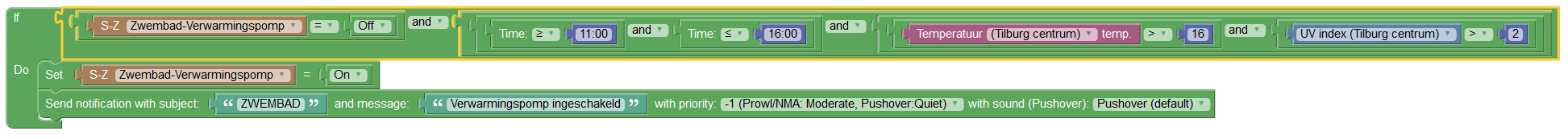

I would to like to automate pomping water through my solar heating panel whenever the sun is clearly shining / heating so i tried the attached event ... (sun is on the solar panels between 11:00 and 16:00)
However, the UVI comparison never works, anyone a idea how to fix this ?

I guess this is due to the fact that the UV is coming from a string of numbers. In my case (don't know if you have the same setup) I don't actually own a weather station but I retrieve the data from Wunderground. Now, if I go to Setup --> Events --> Current States, I get the following from the UV:Korrel wrote:I would to like to automate pomping water through my solar heating panel whenever the sun is clearly shining / heating so i tried the attached event ... (sun is on the solar panels between 11:00 and 16:00)
21 UV 2014-06-04 10:20:01 5.0;0.0
Now, the first value is the UV value (in UVI) and the second value is Watts per m2. Because this is a string instead of a single number, your UVI comparison fails. What you can do is use a LUA script to extract the values and do stuff based on thresholds. I use the following script myself for my sunscreen.
A different solution would be not to build the complete logic in LUA, but only to derrive the values in LUA and posting them to Domoticz using JSON (using Virtual Sensors).
A third option (use with caution!) is to derrive the values in LUA and writing them directly into the Domoticz database (info available on this forum about that).
I hope this helps you!

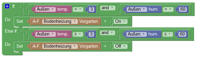

I made my first blocky for the following scenario: Outside temp is below 3°C and humdity is above 60%,
so the heater has to turn on. When the temperature is above 3°C and humdity is below 60%, the heater should turn off again.
Is this approach correct?

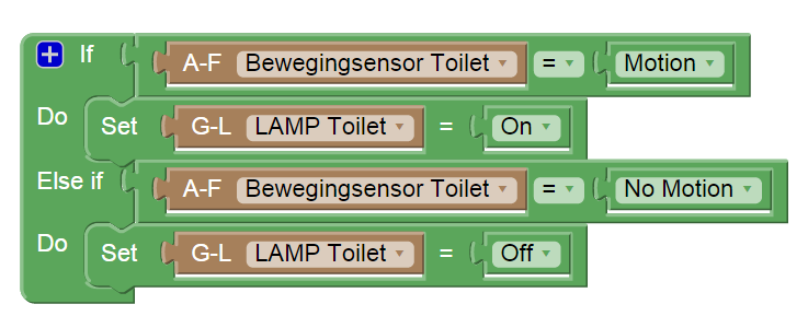

I want to achieve that the toilet lamp is activated when motion sensor is on. And when there is no motion the lamp goes off. This is my (not working) script. What do I need to do?
- Domoticz.png (41.17 KiB) Viewed 41620 times
