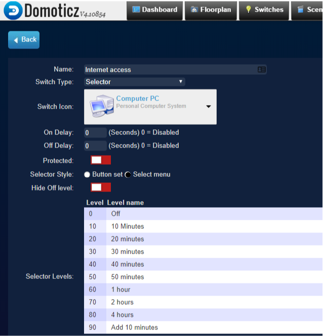

Maybe this dzVents script combined with selector switch and uservar can get you started.
local scriptVar = 'Parental control'
local selector = 'Internet access' -- new virtual selector switch See attached image
local switch =  'Parental internet access control' -- your existing dummy switch
local variable = 'Internet access minutes set' -- define as type integer; initial value 0

The script is working great. I want to improve the UI and usability.
1) How can I turn the Selector status to show On, and it will go off when the timer is out? When I set the Selector the script runs well, but the selector status remains Off.
2) How can I change the script to control a Scene instead of a switch? There are multiple devices connecting to the internet under one scene. It will be useful to control the scene.
3) How can I show a count-down in the Selector Switch Title bar? If the selector was set to 20 min, can I show the count-count value to zero in the Right top bar?
Thank you very much for a great script.

AlleyCat wrote: Wednesday 12 June 2019 13:12 I want to improve the UI and usability.
change line 55 from
item.switchSelector(0).silent()
to
-- item.switchSelector(0).silent()
There is no scene.switchOff() so you want probably a group to do this.
if you change line 28 from
 switch = dz.devices(switch)
to
 switch = dz.groups('your groupname')
it will probably work.
You could force this with the new dz.devices(nnn).rename() method that will become available in dzVents 2.4.24 but the GUI is probably not able to deal with this as the refresh rate of the GUI screen is at least 10 seconds.
