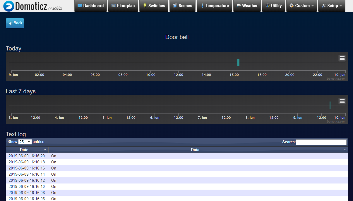

Re: Execute same switch On / On AFTER xx
deve87 wrote: Sunday 09 June 2019 16:05 Yes also tried that. Same result :cry:
:?: Should work :!: What do you see in the log ? Can you share the complete script. It might just help in finding the issue
I tested with this Lua (V4.10881)
    commandArray[#commandArray + 1] = {['Door bell'] ='On AFTER 5 SECONDS' }
    commandArray[#commandArray + 1] = {['Door bell'] ='On AFTER 7 SECONDS' }
    commandArray[#commandArray + 1] = {['Door bell'] ='On AFTER 9 SECONDS' }
    commandArray[#commandArray + 1] = {['Door bell'] ='On AFTER 11 SECONDS' }
    commandArray[#commandArray + 1] = {['Door bell'] ='On AFTER 13 SECONDS' }
    commandArray[#commandArray + 1] = {['Door bell'] ='On AFTER 15 SECONDS' }
    commandArray[#commandArray + 1] = {['Door bell'] ='On AFTER 17 SECONDS' }
    commandArray[#commandArray + 1] = {['Door bell'] ='On AFTER 19 SECONDS' }
return commandArray
relevant domoticz log
2019-06-09 16:16:06.036  (Virtual) Light/Switch (Door bell)
2019-06-09 16:16:08.056  (Virtual) Light/Switch (Door bell)
2019-06-09 16:16:10.035  (Virtual) Light/Switch (Door bell)
2019-06-09 16:16:12.057  (Virtual) Light/Switch (Door bell)
2019-06-09 16:16:14.041  (Virtual) Light/Switch (Door bell)
2019-06-09 16:16:16.066  (Virtual) Light/Switch (Door bell)
2019-06-09 16:16:18.045  (Virtual) Light/Switch (Door bell)
2019-06-09 16:16:20.044  (Virtual) Light/Switch (Door bell)
Door bell.png (141.66 KiB) Viewed 1168 times
