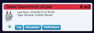

Is it possible to convert the value from P1 Gas "total counter" with value 21.558 to a virtual "General Custom"

Knibor wrote: Tuesday 28 May 2019 20:15 Hi,
Sure but if I take the label literally and you only need the usage of the current year then you need to keep track of the usage of previous years which complicates it a bit (not much because you would have the script store that value in a domoticz variable).
Without that added complexity it could look as short as this.
         on = { timer = {'at *:19'}, -- at least once / hour at a quiet moment
        devices = {'Gas verbruik dit jaar'}}, -- and when the meter got updated
    execute = function( dz )
        local totalGas = dz.devices('Totaal Gasverbruik dit jaar')
        local gas = dz.devices('Gas verbruik dit jaar')
        totalGas.updateCustomSensor(gas.counter)

Hi, thanks for the script gentlemen, the last script works perfectly now.
