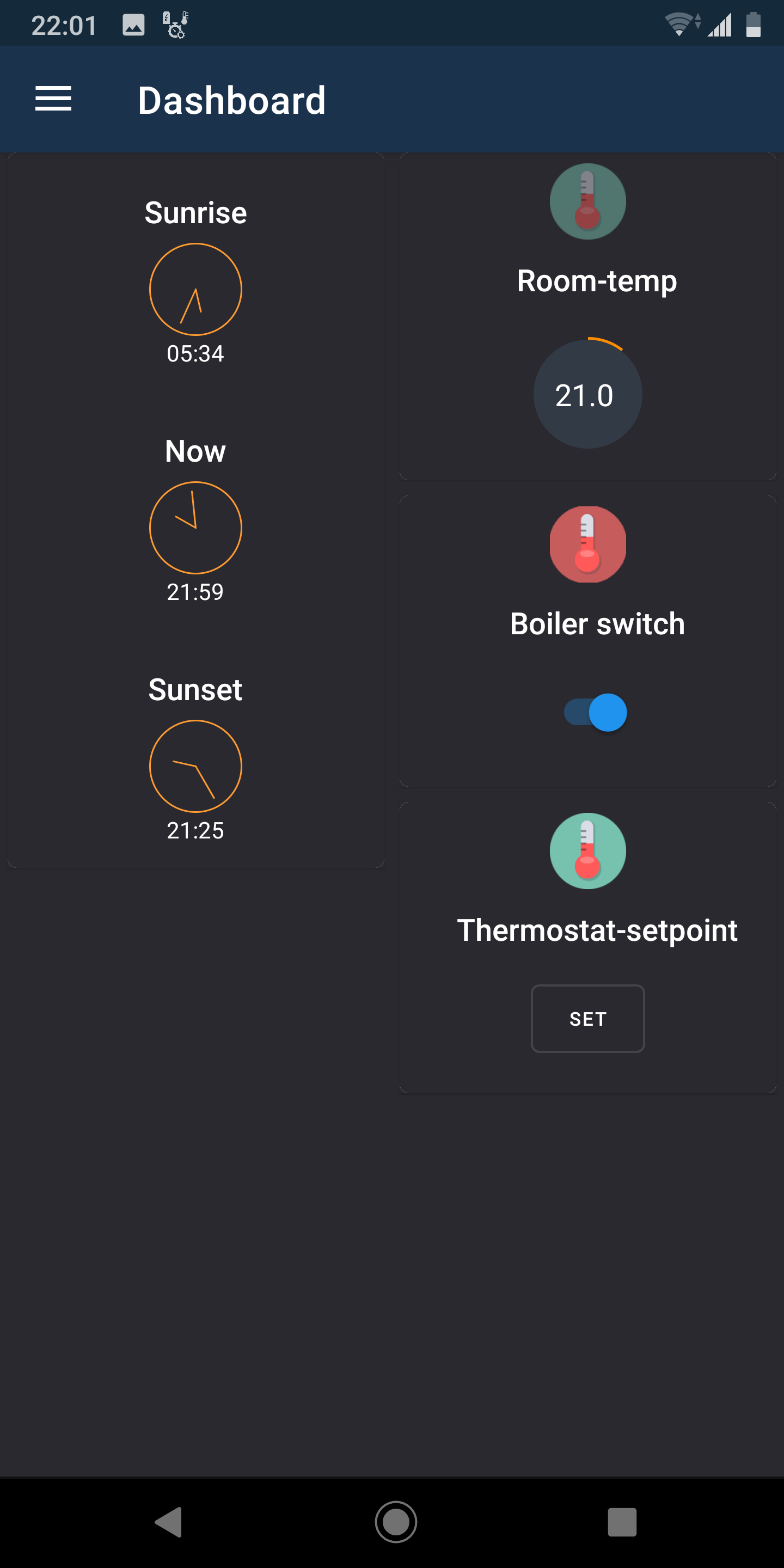

I also don't know too much about Domoticz and I agree that it is amazing software.
To collect icons in one screen I tap or click on the
and those icons will be placed on the dashboard.
Maybe you can use scenes to place icons together as well.
I agree that the thermostat switch is not a peace of simpleness and beauty. It feels stupid to have to click on it and adapt the temperature by typing. A slider would feel more natural.
Solution:
Install Domoticz for Android, pay for the development and enjoy the app. In the app your icons are much more like you would like to have them.
