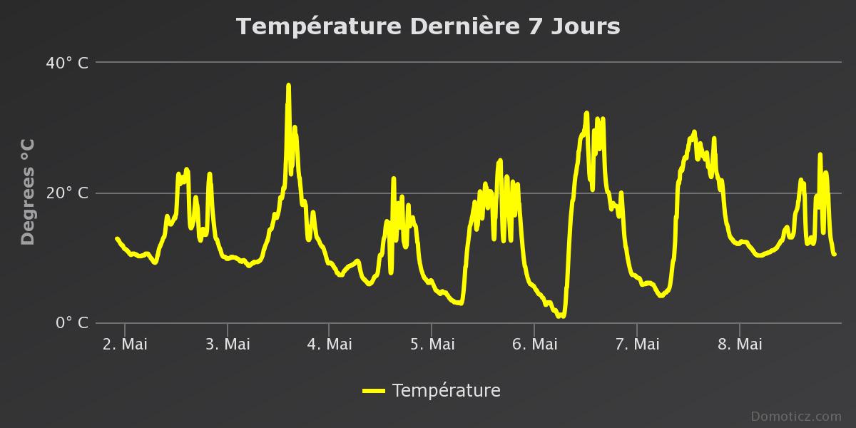

Post by flyertoon »
I would like to receive this by mail. Can you help me? Thanks!!!
see attached file: temp graph

Re: graph by mail
Post by emme »
print it as PDF or save it as image and attach it into an email ;)

Re: graph by mail
Post by flyertoon »
Hello, thanks
My question was not clear. I would like to receive this graphic every day in my mailbox. Automatically, by script I think
Re: graph by mail
flyertoon wrote: Thursday 16 May 2019 20:23 My question was not clear. I would like to receive this graphic every day in my mailbox. Automatically, by script I think
I don't think it's possible to get it as a graphic. Closest you can get is get the underlying data.

Re: graph by mail
Post by flyertoon »
... how can i get underlying data please ? or where are stored the log ?
thanks
Re: graph by mail
flyertoon wrote: Friday 17 May 2019 13:07 ... how can i get underlying data please ? or where are stored the log ?
A dzVents script to do this could look like the one in the code window below.
