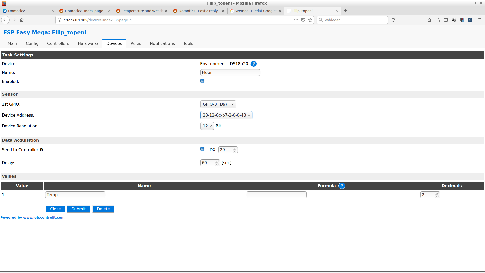

kimot
- Posts: 113
- Joined: Saturday 25 November 2017 17:18
- Domoticz version: v3.8153
- Location: Czech Rep.
Re: DS1820 temp sensor
ESP8266 is processor with wifi on board.
You can buy different boards with this processor.
I suggest Wemos D1mini for first experiments.
For ESP8266 you can write your own programs in Arduino IDE for example,
OR you can use firmwares ( writen by other peoples ), which are ready for connecting different sensors to ESP8266 and sending data to Domoticz for example.
One from those firmwares is ESPEASY.
Then you create in Domoticz dummy temperature sensors and make notice about his IDX.
Then you load to your ESP8266 firmware ESPeasy ( downloaded .bin file )
Through web interface on running ESPeasy you set to which pin is connected your DS18B20 bus ( or other types of sensors ),
select specific DS18B20 ( if more then one on bus ) and IDX ( marked when created in Domoticz ).
ESPeasy will send temperature to Domoticz then automatically.
