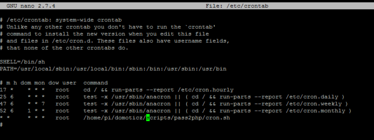

ok, put the script in the /home/pi/domoticz/scripts/pass2php folder and gave it the 777 rights.
is this crontab filled in correctly(as it looks different).
2019-05-05 12_37_18-192.168.1.200.png (156.87 KiB) Viewed 1550 times
sincze
Posts: 1302
Domoticz version: 2024.4
Re: Pass2PHP
Post by sincze »
Looks okay on my phonescreen.
User root will call the file Evey minute ;) :D
Usually you pipe the output to something with the > But don't know that by heart. Give it a Google search what the best option would be. This could work.
