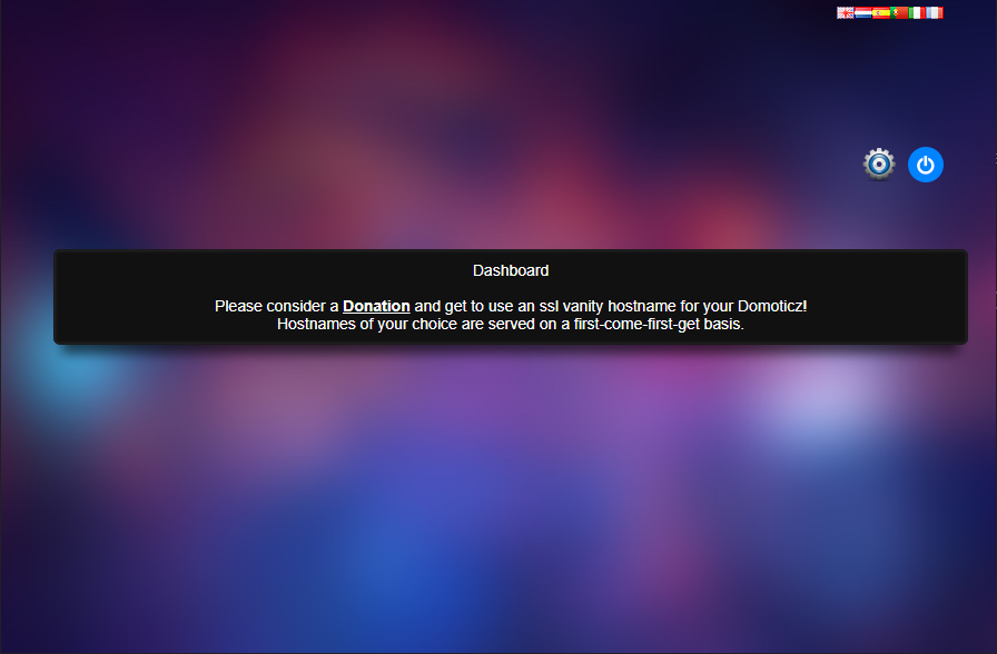

I need some help with mydomoticz, I was happy to finally get it working yesterday, but now my proxy dashboard is empty:
20190523 105932 user.png (213.14 KiB) Viewed 2648 times
All I did was change the instance name from "MyDomoticz" to "Házikó" (little house in Hungarian).
The accented characters might did something.
How do I fix this please?
Thanks in advance!
BR:
Peter
chimit
Posts: 259
Joined: Saturday 18 April 2015 18:55
Domoticz version: master
Location: Rotterdam, the Netherlands
Re: MyDomoticz - Testers wanted!
Post by chimit »
Hi, could you try again?
Let me know the results by PM.
== Rene

Unfortunately I cannot PM you, this feature is disabled for me (recently registered).
The green guy is back though, thank you for your quick help!
Was my suspicion right? I should not have used accented characters?
Thank again!

Yes, your suspicion was right.
There's a development version in the make that doesn't have that quirk.
Unfortunately there's no release date known for that yet.
Regards,

Today i want to login again, am not able to succeed.
I fill in emailaddress and password (did not use 2 factor code) and press Sign in, then a yellow area comes up without any text.
BurningTyre
Posts: 30
Joined: Wednesday 21 August 2019 15:44
Domoticz version: 2025.1
Location: Arnhem, The Netherlands
Post by BurningTyre »
ah. That refresh (F5) works!
Now i have sometimes on the next page, when i click on the green doll to go to my dashboard. It looks like there is happening something but i directly come back to the same page and do not go to my own dashboard.
