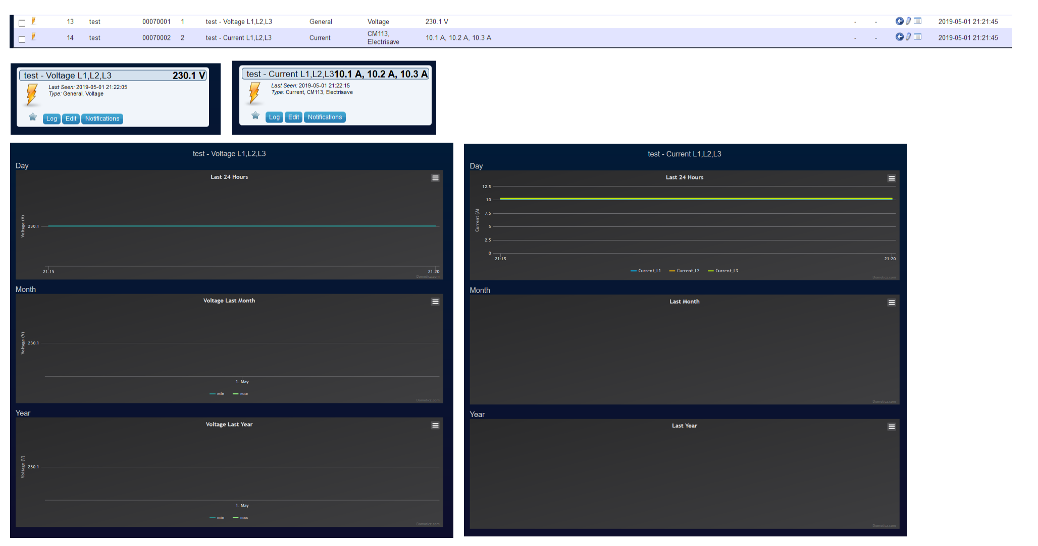

Hello Reader,
I have a question about adding creating a plugin with the plugin framework. My goal is to combine a number of values of measurements in a domoticz device.
Create devices example:
    if 1 not in Devices:
        Domoticz.Device(Name="Voltage L1,L2,L3", Unit=1,TypeName="Voltage",Used=0).Create()
    if 2 not in Devices:
        Domoticz.Device(Name="Current L1,L2,L3", Unit=2,TypeName="Current/Ampere",Used=0).Create()
Update devices example:
    Devices[1].Update(0,str(230.1)+";"+str(230.2)+";"+str(230.3))
    Devices[2].Update(0,str(10.1)+";"+str(10.2)+";"+str(10.3))
The code is working with this simple plugin.py
What I just don't understand is why this doesn't work for voltages and it does for currents. I made the assumption that with this constuction you could build any available device with measurements of the same type. Below a number of merged images where you can see what I mean. I have also added the log file for clarification.
Can someone help me to combine measurements of the same type in a domoticz device?
