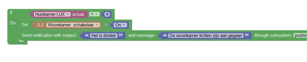

OKe, just got my new sensors (Aqara body en light sensor)
I want to make a blocky wich will turn my light on when it becomes dark. It looks how many LUX there are and if the are below 4 it turns on my light.
And it does, but won;t go out anymore becasue at night its below 4 to hahah
How to solf this?
How to solf this?
- lichten.jpg (39.36 KiB) Viewed 2082 times

Suggestion:
insert an extra clock-related time-gate which only allows switch-on in the evening.
Something like
IF ((light <4 ) AND ((Time > 17:00) AND (Time < 23:00))) THEN ......
Something like

Great idea, thank you..
