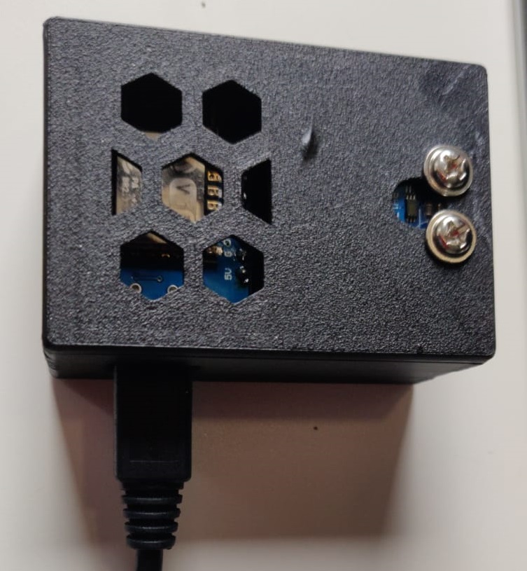

I finally finished my project in a $4 enclosure obtained from ebay using a Wemos D1 and tasmota.
Finished Sensor-dom.png (214.86 KiB) Viewed 1865 times
I added a 3,3v Temperature Humidity Sensor GY-213V-HTU21D I2C as well. In my bedroom is always dark so the intentional LUX meter was absolute overkill.
So created a separate LUX meter for the livingroom
