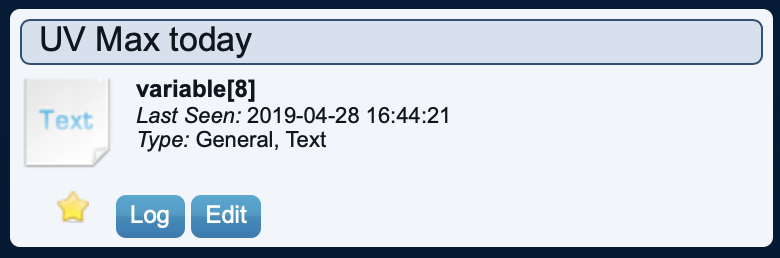

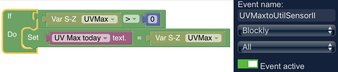

We have read a lot of Domoticz posts but we can’t find the solution with Blockly.
With the UV meter we have a blocky script that put the max UV Value of the day into a Variable.
That works.
But we want the value of that Max UV value into the Dashboard.
So, because it’s not possible to display a variable directly at the Dashboard with Domoticz, we made a Utility Text Device “UVMax today” and a blocky script to put the value of the UVMax Variable into that Utility Device. But that won’t work.
The result in the Util Device is “Variable[8]”
Is it not possible with Blockly to put a Variable value into a Text Device?
Thanks for the help and kind regards,
John

- Screen Shot 2019-04-28 at 16.49.45.png (53.94 KiB) Viewed 5021 times
- Screen Shot 2019-04-28 at 16.45.32.png (83.59 KiB) Viewed 5021 times
