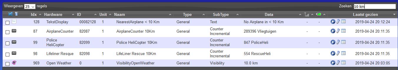

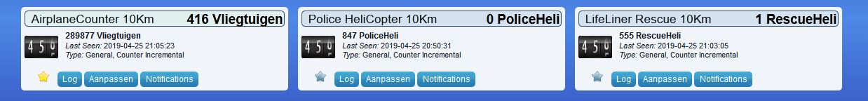

Guys, can you please help me understanding.
I have 3 counters as listed below with individual idx's 87, 99 and 98
I would like to get a notification when the 99 or 98 counter does get incremented however it I enable the below Lua I do get notifications from the idx 87
as well, more over incremented the idx 87 by 1 give an notification of 98 and 99 at the same time.
I am sure I am missing something.. please advice.
Thanks in advantage , Frank

freijn wrote: Wednesday 24 April 2019 20:22 I have 3 counters as listed below with individual idx's 87, 99 and 98
If I look at "laatst gezien" all your counters got updated at the same second. Are they updated by a plugin or script ?
Please note that devicechanged["name"] will return true when the lastUpdate field is updated. This does not necessarily mean the value of the counter has changed.

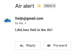

Waaren
Thanks for the script ! Set it in production.. now wait till the Heli fly over.
(to speed up I could make a phone call :-) )
no no, just a joke
freijn
Posts: 536
Domoticz version: Stable
Re: trigger on counter not selective :-(
Post by freijn »
Waaren
Thanks !!!!
