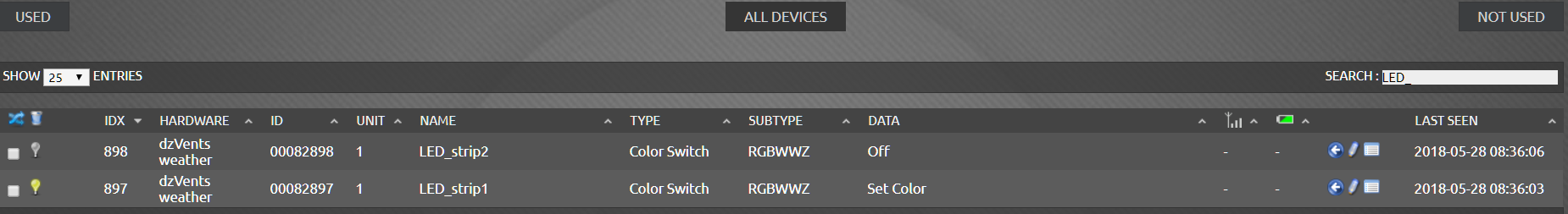

well i do not have dzvents hardware but these are my devices
i hope this helps you?
raspberry pi | xiaomi vacuum | yeelight | philips hue | zwave | ubiquiti unifi | harmony | sonoff | zigbee2mqtt | https://www.youtube.com/channel/UC2Zidl ... m1OLuNldfQ
Re: sub slave devices
@snellejellep,
:) DzVents weather is just a name of one of my dummy hardware. In use only to define virtual devices.
and yes this is the information I need to continue my little script puzzle. Will get back to you once I have something and tested the different scenarios.
