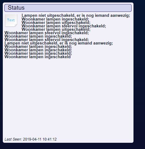

i have a textdevice which i use to display the last status.
is there a way to display multiple lines so i can use it as a log.
e.g. i use this comand at the moment
domoticz.devices('Status').updateText('Woonkamer lampen ingeschakeld')
which displays Woonkamer lampen ingeschakeld
now when i issue a second command like
domoticz.devices('Status').updateText('Alarm ingeschakeld')
i want to see the most actual one on top and the other one below
Alarm ingeschakeld
i know this can be done in lua(but i do not know how) butdoes this work in dzvents

Thanks,
got is working(sort of)
the problem i have now i need to limit the amount of lines to max 5 i think
is there an easy way to do this
this is my code
currentstatus = domoticz.devices('Status').state ..'\r\n'
newstatus = 'Woonkamer lampen sfeervol ingeschakeld'
currentstatus = newstatus .. ';\r\n'..currentstatus ..'\r\n'
domoticz.devices('Status').updateText(currentstatus)

Gravityz
Posts: 652
Domoticz version: 2025.1
Re: multiple textlines in textdevice
Post by Gravityz »
this indeed works with limiting the messages
however as far as i can see the top line is changing but the others are not.
the idea is that when things change the old messages shift down.
eg
a
b
c
d
e
new message f
f
a
b
c
d
new message h
h
f
a
b
c
i think i need to combine things from the old code and your new code but this is looking promising

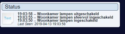

Gravityz wrote: Thursday 11 April 2019 13:41 this indeed works with limiting the messages
If I understand your requirement correct, the function addRollingTextLine in below script should do it.
			on =    {

Gravityz
Posts: 652
Post by Gravityz »
Hi waaren.
that code works very nice
the only downfall is that i need to add it to every script that is updating the status device.
is it possible to put this into some kind of module or helper function.
eg declare it once and then call it from every script you like

Post by Gravityz »
Thanks waaren, you made my day.
i have read that myhelper part multiple times over and over again and could not figur out how it was working, until now.
after reading MORE CAREFULLY i noticed what i was doing wrong
working perfectly now
i now can use the Status textdevice as a logging device lights on/of alarm on/off sunscreen in/out. al the things i normally wrote to the log are now visible
