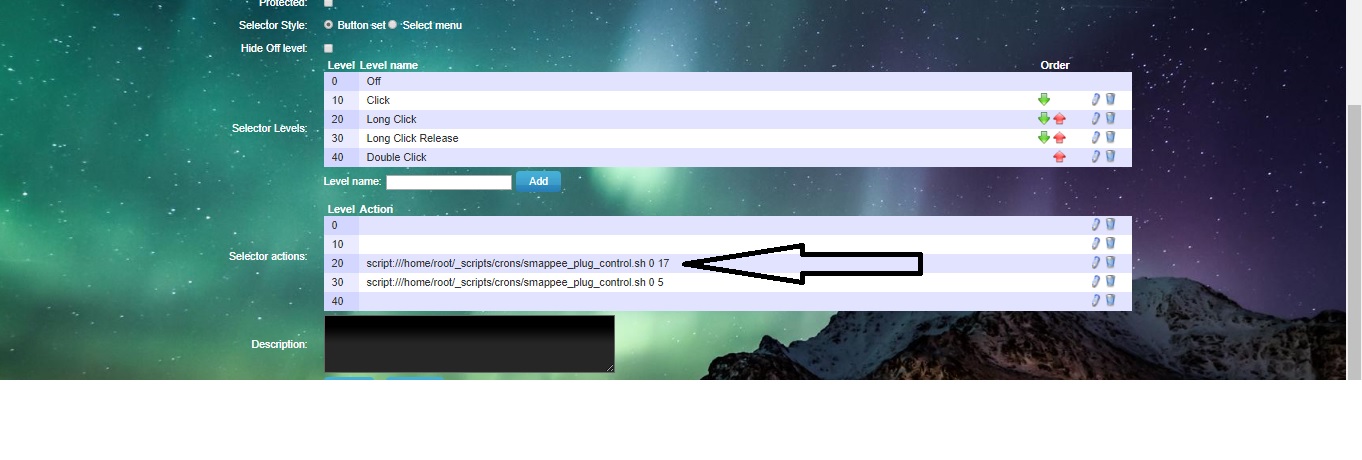

is it possible add more Selector actions in a cell??
selector actions.jpg (131.79 KiB) Viewed 4445 times
SweetPants
Re: Enable lua (time) script by switch (possible?)
Post by SweetPants »
matteos1 wrote:is it possible add more Selector actions in a cell??
If you want to ask a non-related question, please open a new topic. This gets confusing and you may not get an answer

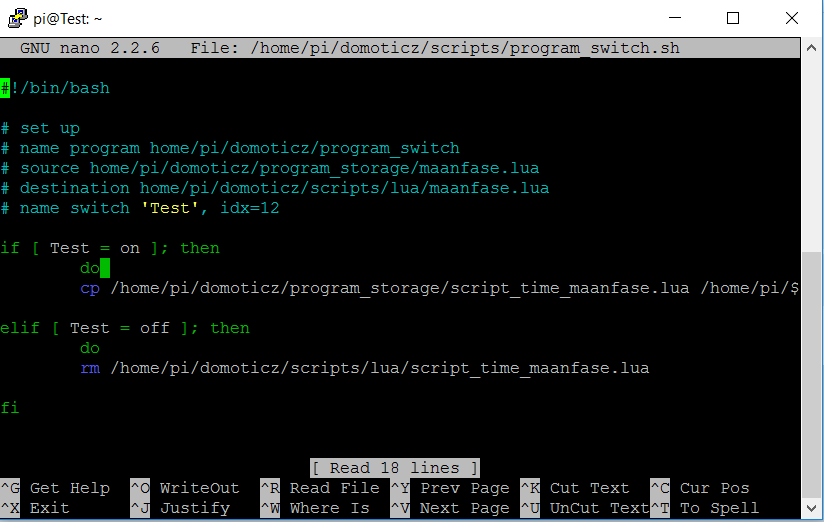

Based on my limited knowledge, I first try this option. So far, I could copy and paste the necessary codes. But in this case, I could not find the suggested code. I made one myself but I failed.
Steps I made:
- Created a virtual switch 'Test' idx=12;
- In the /domoticz/ directory, I created a new directory "program_storage" in which I installed the "script_time_maanfase.lua" code;
- The following code was placed in the /domoticz/scripts/ directory.
- execute sudo chmod+ program_switch.sh
When I turn the switch 'on' nothing happens > also no errors in domoticz and syslog. Conclusion: I need help in making the next step.
Thanks in advance.
