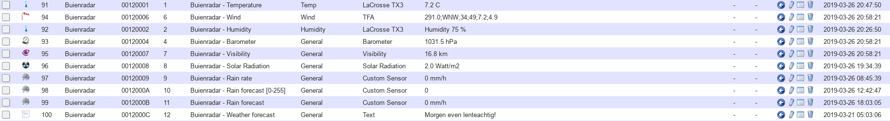

@SweetPants.
The "Last Seen" for this text device is exactly, what is shown at the screenshot of the sensor.
Below you will see a screenshot for devices of "Buienradar".
As you can see the text device is the only device, that stops.
Buienradar- Device_Overview.png (76.52 KiB) Viewed 4227 times
I will continue and do more checks
Thanks for your answers so far

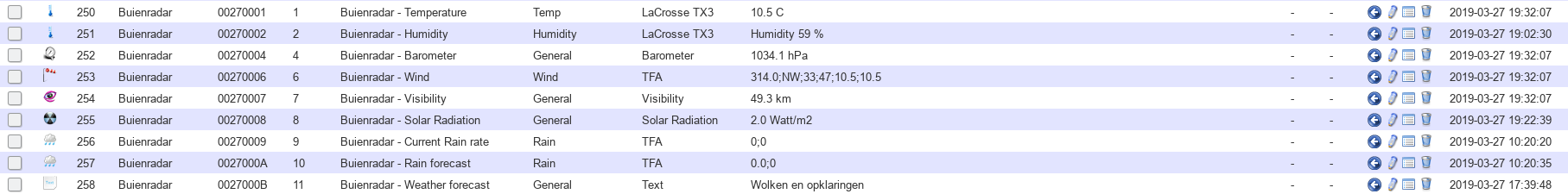

Post by FireWizard »
Deleting the text sensor only did not work. Even after an updated text message has been received this morning, Domoticz did not add a new text device.
The next step was to delete Buienradar.nl (Weather Lookup) completely in "Hardware". So you will loose all Buienradar devices. Just to be sure I did a reboot of the RPI. Don't think that that is necessary, but just to be sure.
Afterwards I added Buienradar.nl (Weather Lookup) again in Hardware and it created 9 new devices, among them a text device.
I noticed some significant changes compared to the previous version.
In the old version the plugin created 10 different devices; the latest version from github creates 9 devices.
The 6 first devices are the same, but then comes the difference.
In the old version version you will find 3 custom sensors (Rain rate (mm/h), Rain forecast [0-255] and Rain forecast (mm/h)). These 3 custom sensors were published under the utility tab. (See the screenshot above).
In the latest version these 3 sensors are replaced by 2 new sensors, placed under the Weather tab (Current Rain rate (mm) and Rain forecast (mm)).
The text sensor you will find back under the Utility tab, as before. See the screenshot below.
Buienradar- Device_Overview_New.png (65.34 KiB) Viewed 4194 times
Although I think that one forecast is sufficient and see it as an improvement, I also believe that this is the cause that updating the text sensor stopped.
This was already suggested in some way by SweetPants.
Thanks everybody for their suggestions.
