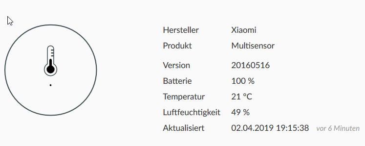

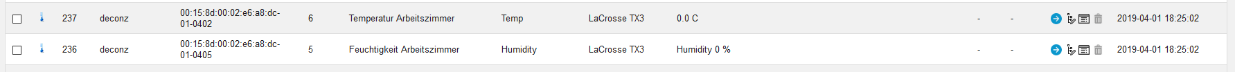

I'm using this one: Xiaomi Mijia Smart Temperature and Humidity Sensor ( https://www.gearbest.com/living-applian ... id=1433363 )
And like you see it works fine in Phoscon: And in Domotic are two new devices since i add the sensor to phoscon. But there is no temperatur or humidity level shown. Just Zero:
It seems that it doesnt update the device like you see at the last time seen. Did i made anything wrong at inclusion? The included Osram switch works fine, so connection is there.

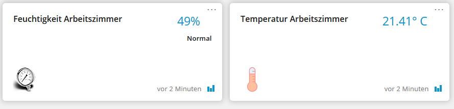

Update1:
OK Sorry for this confusion... now i update the deconz plugin by clicking update in the device page. And the devices syncronize. But only when i update the deconz plugin manualy. If the temperatur changes in phoscon, it doesnt change in domoticz... Ok Update 2. I found this in domoticz log:
Update1:

If all is ok, you will receive websocket information every hours or if the temperature change. Something like that if you enable debug.
I have produce theses log with taking the sensor into my closed hands.
For information you need to resynchronise the plugin every time you chnage something on deconz, it will work without problems, but you can miss information or have strange error on log.

2019-04-02 19:54:47.035 (deCONZ) ###### WebSocket Data : {'state': {'pressure': 994, 'lastupdated': '2019-04-02T17:54:47'}, 'r': 'sensors', 'uniqueid': '00:15:8d:00:02:3f:38:56-01-0403', 'id': '19', 'e': 'changed', 't': 'event'}
2019-04-02 19:54:47.037 (deCONZ) ### Update device (deCONZ - Multi Sensor) : {'sValue': '994', 'nValue': 0}, IGNORED , no changes !
