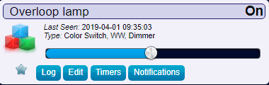

I have a Xioami zigbee lamp, which can be set by color temp and brightness.
The Domoticz Gui works (although the setting of color temp cannot be saved)
The command from the gui in the domoticz log is:
Status: setcolbrightnessvalue: ID: 333, bri: 50, color: '{m: 2, RGB: 000000, CWWW: 7788, CT: 136}'
How do I accomplice this in DzVents? I am using domoticz 4.10580 with dzVents 2.4.16
