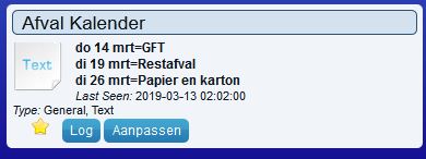

freijn
- Posts: 536
- Joined: Friday 23 December 2016 16:40
- Domoticz version: Stable
- Location: Netherlands Purmerend
Re: Sharing : Afval kalendar in text sensor
What weekday ??
All is in already ?
All is in already ?
- Capture.JPG (19.89 KiB) Viewed 2248 times
