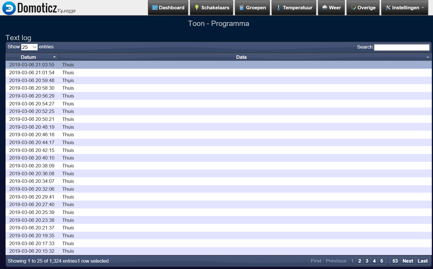

Every 2 minutes the statusses are updated.
But is also updates a state when the state is already the right state.
See the attached image. My scene-selector is updating its status every 2 minutes to the same state.
This causes a very long log. The bigger problem is that it triggers scripts which are set to react on 'device changed'.
Is it posible to check the actual status of the switches before updating it?
Only update it when its another status?

Seems a valid request.
I will have a look. Preparing a new release that supports modulation level and program state.
