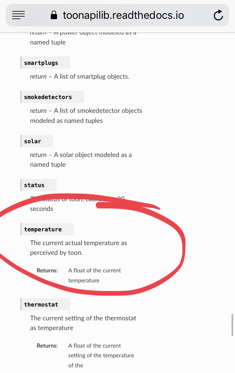

waspy wrote: Friday 01 March 2019 12:41
eenernl wrote: Friday 01 March 2019 7:21
eenernl wrote: Friday 01 March 2019 1:39 It looks like the room temperature sensor has a precision of 0,5 degrees? Just like it’s displayed on the Toon itself.
The previous integration had a precision of 0,1 degrees. Is this possible to change? Then the measurement will be more accurate.
you see?
The temperature is retrieved through the toonapilib which reads the currentDisplayTemp variable from the Toon web api.
There are not other temperature readings that can be used to have a more accurate reading.
Apparently, the precision of this and other temperature related variables is 0.5 degrees.
One can argue how accurate the temperature reading actually is...
Hmm... previously the precision was 0.1 degrees.
More accurate then the displayed value. There should be a possibility to get the real measured value.
If I look at https://toonapilib.readthedocs.io/en/la ... pilib.html I think it should possible.

That's exactly the attribute I use.
The eneco servers do not expose the 0.1 precision readings anymore. It exposes only the displayed toon temperature. Which has a 0.5 degree rounding.
Verstuurd vanaf mijn SM-G935F met Tapatalk

Are you sure?
Because there is also a value for the displayed temperature:
Can’t we ask quby for this?

Thanks waspy for helping out before! I wanted to add a bit more customization so I've just been playing around with some python that uses the latest toonapilib library. The Lua scripts that controlled the thermostate state or setpoint temperatures are now working smoothly again. :)
I've added currentModulationLevel (also see below) in Domoticz as well as a temperature device. It's interesting to compare that value to the temperature of the water that flows out of the boiler/CV.
And yes the precision readings are not accesible at the moment:
  "currentSetpoint": 2000,
  "currentDisplayTemp": 2000,
  "programState": 0,
  "activeState": 1,
  "nextProgram": -1,
  "nextState": -1,
  "nextTime": 0,
  "nextSetpoint": 0,
  "errorFound": 255,
  "boilerModuleConnected": 1,
  "realSetpoint": 2000,
  "burnerInfo": "1",
  "otCommError": "0",
  "currentModulationLevel": 19,
  "haveOTBoiler": 1,
.. is as good as it gets but that's okay for most intents and purposes.
