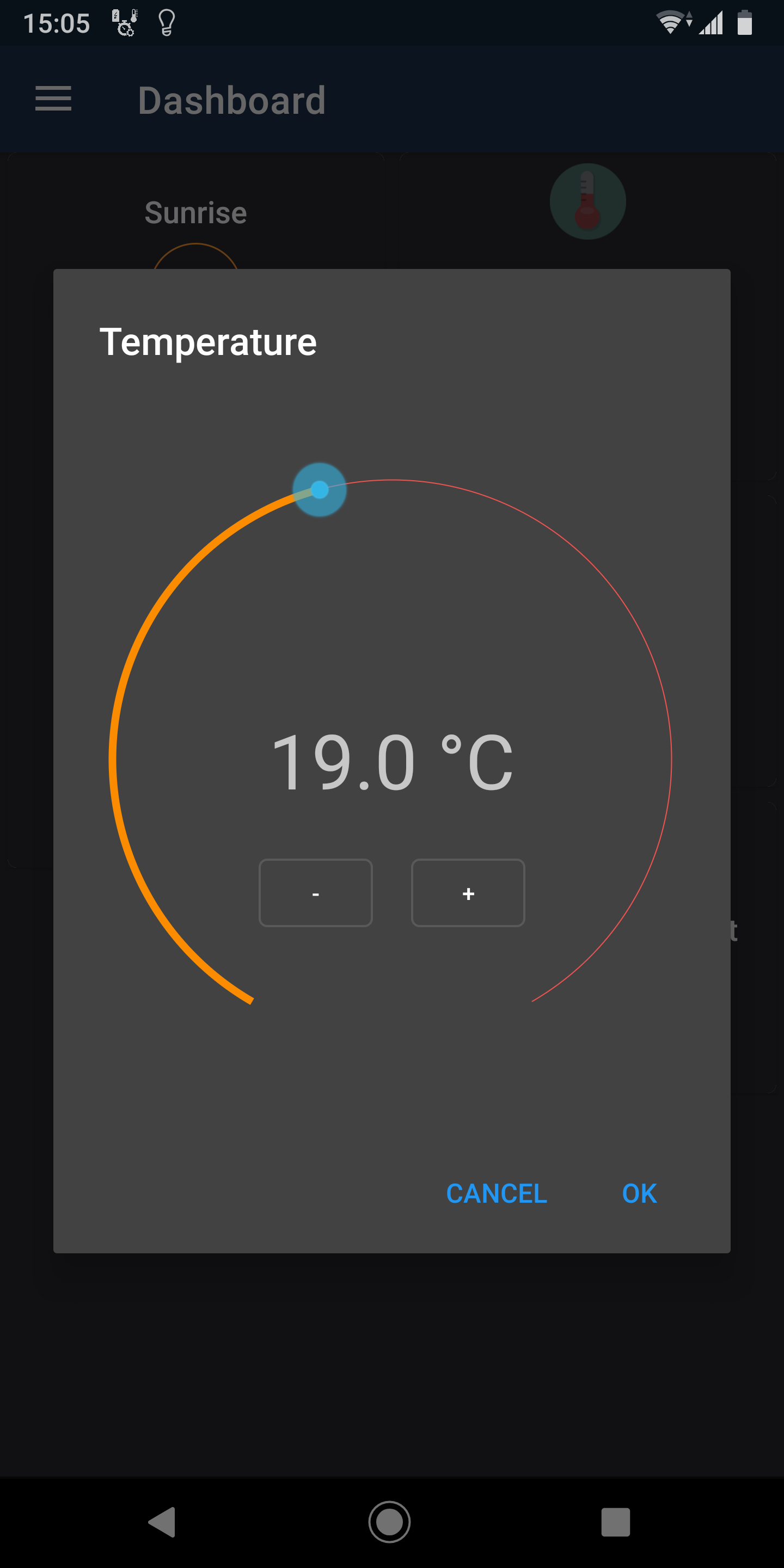

HvdW
- Posts: 663
- Joined: Sunday 01 November 2015 22:45
- Domoticz version: 2023.2
- Location: Twente
Re: Controlling temperatures etc
On the web interface of Domoticz you have to type the desired temperature.
The interface on the Domoticz app is different.
Maybe that serves your needs.
- Screenshot_20190519-150516.png (117.88 KiB) Viewed 1998 times
