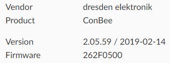

I've disabled the deCONZ package on my Domoticz and installed it on a old RPI.
Don't really know how to check for deconz-latest.deb version. :(
And yes... It's installed on a separate RPI (RPI1 actually) and the USB is attached to that one.
The version is:
The new version was running on my Domoticz a couple of days.... but the CPU was still high.. after disabling it went down to approx 2% again.
And yes... The Domoticz on RP3 and deCONZ on a RP1.

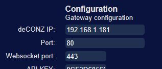

So Domoticz is requesting info from my RP1 and I've this settings in my hardware page:
where my RP1 is using the IP: 192.168.1.181
and Domoticz is using: 192.168.1.59
No editing the code whatsoever..

To see deconz version.
- on deCONZ : Help / about deconz.
- on phoscon : Setting / gateway (like you have done).
ATM on the PI1, you have the lasted one (with the corrective, but it don't mean it is without bug).
But I can't understand why it works on your side, see some posts before you, websocket can't works with standard version, because I m using "127.0.0.1" as domoticz ip (coded in hard, line 53 in plugin.py), the beta have been corrected but not in master branch. To resume, you can send command, but you can't receive them if domoticz isn't on same machine than deconz.
I can't say if the problem is from deCONZ or domoticz, but on deconz, some users had this kind of bug because of upnp. They have disabled it.
To make try, you can disable deconz ssdp service by editing systemd file and append --upnp=0 or use it in command line. But it's just for test because with this command your gateway will be invisible for other machine on your network.

tcp        0      0 0.0.0.0:5900            0.0.0.0:*               LISTEN      504/vncserver-x11-c
tcp        0      0 0.0.0.0:80              0.0.0.0:*               LISTEN      10422/deCONZ
tcp        0      0 0.0.0.0:22              0.0.0.0:*               LISTEN      516/sshd
tcp        0      0 0.0.0.0:8088            0.0.0.0:*               LISTEN      10422/deCONZ
tcp6       0      0 :::5900                 :::*                    LISTEN      504/vncserver-x11-c
tcp6       0      0 :::5008                 :::*                    LISTEN      10422/deCONZ
tcp6       0      0 :::8080                 :::*                    LISTEN      524/domoticz
tcp6       0      0 :::22                   :::*                    LISTEN      516/sshd
tcp6       0      0 :::443                  :::*                    LISTEN      524/domoticz
tcp6       0      0 :::6144                 :::*                    LISTEN      524/domoticz
udp        0      0 0.0.0.0:1900            0.0.0.0:*                           10422/deCONZ
udp        0      0 0.0.0.0:68              0.0.0.0:*                           338/dhcpcd
udp        0      0 0.0.0.0:5353            0.0.0.0:*                           279/avahi-daemon: r
udp        0      0 0.0.0.0:49464           0.0.0.0:*                           279/avahi-daemon: r
udp6       0      0 :::40518                :::*                                279/avahi-daemon: r
udp6       0      0 :::5353                 :::*                                279/avahi-daemon: r

You don't have something interesting in your logs in your second isues ? When the websocket have stoped working ?
Wich one deconz are you using ? the last one is not necessarily the better (the 2.05.58 have the cpu problem). On my side I m still on 2.05.55 with domoticz and deconz on same Pi3.
