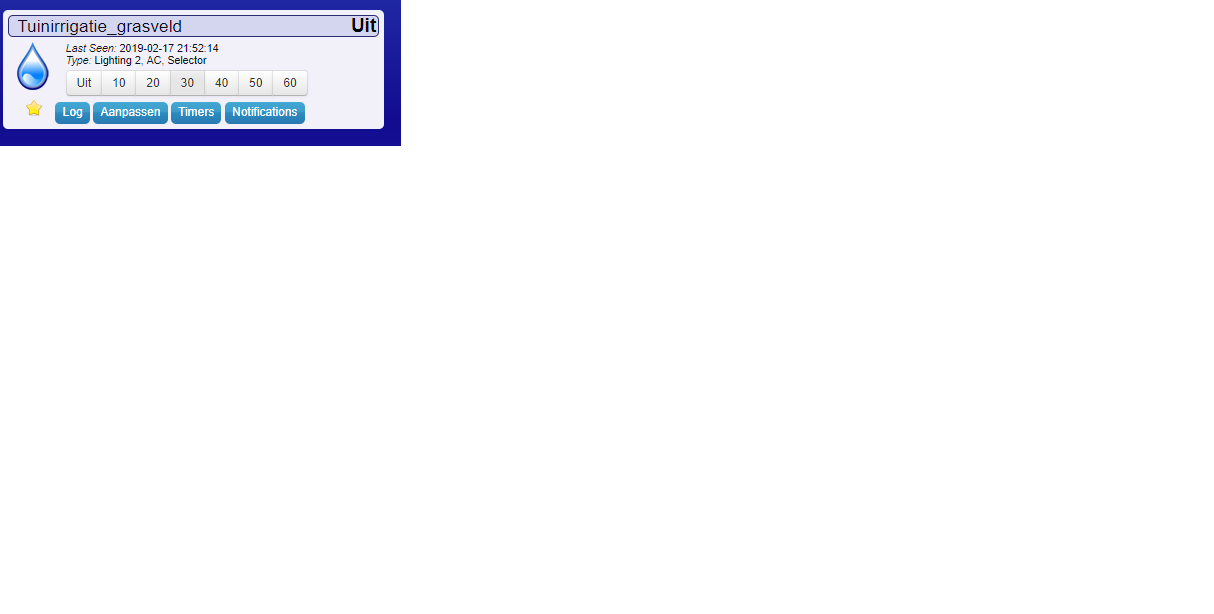

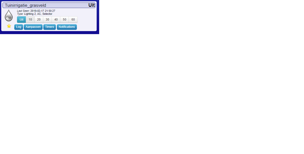

Learn mode, and then i changed the devices to selectors with buttons.
problem is that when i click the device, say 20, it does switch on for 20 seconds... but during those 20 seconds it does not lightup the 20 button with the color that usually is used when selecting a button...
Also ON/OFF is not the right value during those 20 seconds...
I think it is because off teh script with both an off and a on event
So its more an UX (i=usability thing)
see attachments

pvklink wrote: Sunday 17 February 2019 21:41 Learn mode, and then i changed the devices to selectors with buttons.
see attachments

    local waarde2 = dz.devices('Tuinirrigatie_borders_waarde').level
    local waarde3 = dz.devices('Tuinirrigatie_plantenbakken_waarde').level
    if device.name == 'Tuinirrigatie_grasveld' then
        waarde = waarde1
    elseif device.name == 'Tuinirrigatie_borders' then
        waarde = waarde2
    elseif device.name == 'Tuinirrigatie_plantenbakken' then
        waarde = waarde3
    if device.state == 'Off' then
        switch.switchOff()
        dz.log("Script: " .. info.scriptName .. " Device uitgezet....", dz.LOG_INFO)
        device.switchOn().silent()
        device.switchOff().afterSec(waarde).silent()
        dz.log("Script: " .. info.scriptName .. " Device " .. device.name .. " voor " .. waarde .. " seconden aangezet....", dz.LOG_INFO)
