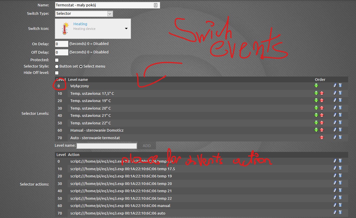

Well...I'm using Bluetooth thermostats, so I'm connecting to them using external library and script.
For example:
script:///home/pi/eq3/eq3.exp XX:XX:XX:XX:XX:XX temp 5.0
Switch events.jpg (165.89 KiB) Viewed 1649 times
so temperature settings on thermostat is solved by this script calling from Selector Switch(dummy switch) settings.

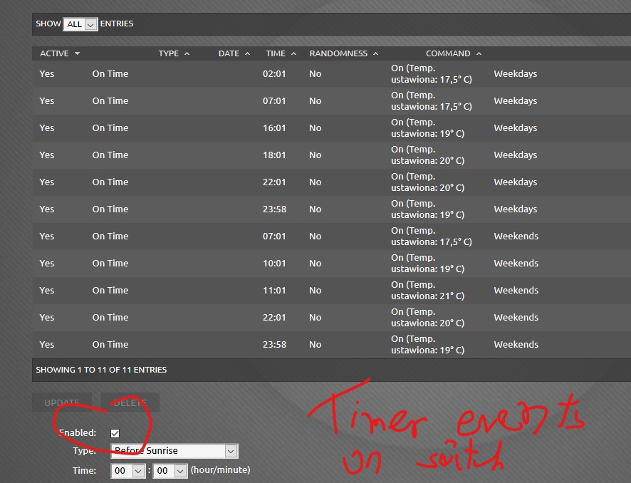

Now I need just dzVents for disabling plans (Timers) on this switch (for example when I'm going to holiday). I do not want to unselect every single event in switch Timers.
So the question is how to call to Timers from Selector Switch in dzVents to turn them On and OFF with just one click (best way using one of Selector levels)?
