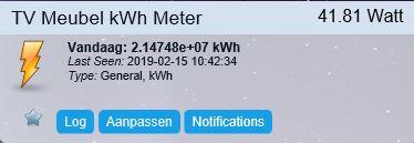

Same here, after amending the .xml file, rebooting, delete and add the plug, the power plug is recognized but cannot change device parameters and the kWh measurement reads an abnormal 21474836.62 kWh

KWh usage shows -2.14748e+07 kWh
Watt usage is ok

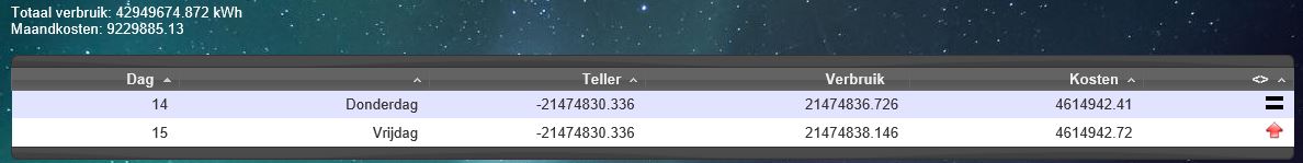

I have the same problem. Did upload new config files, device is recognized correct now but kWh is not working correctly. Also configuration parameters can't be changed.
KWh usage at dashboard shows 2.14748e+07 kWh
In devices it shows however a kWh which looks correct but is too high in my opnion.
In logs it shows strange counter values.
Hope anyone has any ideas, thanks!

Well I exclude and include it and configuration parameters are working but my kWh reading is still incorrect in Domoticz (-2.14748e+07 kWh)
I also tried to get it back to factory default (hold power button for 10 seconds). But after doing this and include it again the counters (total kWh) isn't reset. However it looks like reading it out ok if I look in the OpenZwave panel, so I don't understand why domoticz is still displaying it wrong.
Any ideas?
