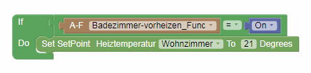

And then I made the Blockly-table for the selector switch (ignore the telegram notifications):
So, for example:
I have to get up at 6 o'clock. I will turn the selector switch "Vorheizen Badezimmer" to "Aufstehen: 6 Uhr" ("Stand up at 6 o'clock") the evening before.
So the normal switch ("Badezimmer-vorheizen_Func") will be turned on for 120 minutes, which means, that the temperature is set to 21 degrees.
But I have to include the time! In this example I have to include "at 5:00,that the switch is switched at 5 o'clock. How can I do that?

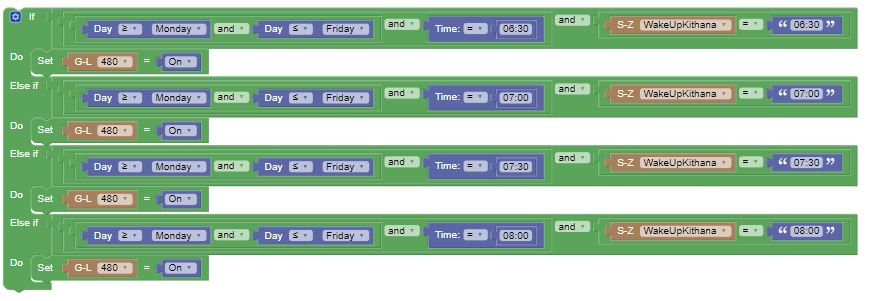

If you use the "AND" function, it will work. So like this:
If (switch) = "wake-up at 6" AND the time = "05.00"
SET .....
You know what I mean? That way it looks at you switch and checks the time before it will do an action, in your case turn the heating on.
I have this running which looks a lot what you want:
