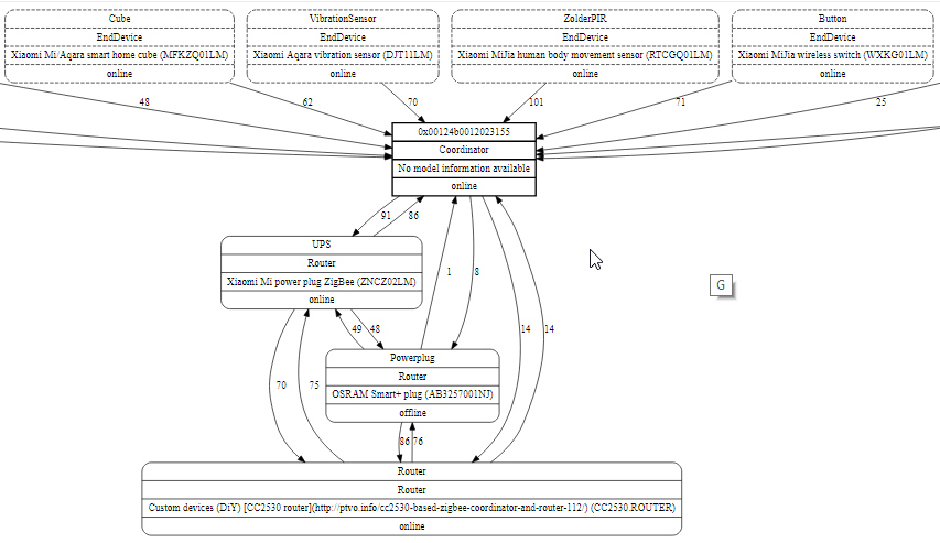

After the upgrade I have this configuration.
This is different from my previous configuration.
I see 16 lines towards the Coordinator. Does this mean that I am towards the limit and that might be the reason that nothing more can be added?
The total is only 13 real devices and that's below the limit.
Remarkable is also that due to physical circumstances the Powerplug should only connect to the Router, but Powerplug connects to the 2 other routers and the coordinator. I suppose that the numbers are the signallevels.
Can anyone enlighten me how to get more devices connected?
