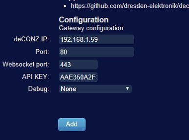

Lol. I prefer that. But it's still a problem.
I think the problem is line 127 in plugin.py file, you can check fast with editing the line 53 (still plugin.py file)
DOMOTICZ_IP = '127.0.0.1' and using your network IP.
In fact Its easier to put deconz and same machine than domoticz (only 1 computer running) So I think you are the first one with this kind of instal.
Now you have 2 solutions.
1 - Stay like that and try my modification on plugin.py file, if it works, i will make something more official (an editbox on the config)
2 - Move deconz on your pi, but you will loose 50% of your configuration, deconz save 50% of the config on the conbee and 50% on the computer. So if you don't know where to find the xml file to copy them, you will have to remake all your installation (and It's easier to reset all, than trying to repair, I have tried too ...)
The problem is on my side, you can keep your installation like that.

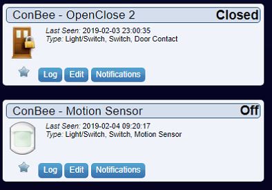

I does read the list of sensors... I'm able to add them to Domoticz But there seems to be some issues here...
2019-02-03 22:21:19.890 (ConBee) onConnect called
2019-02-03 22:21:19.891 Status: (ConBee) onDisconnect called for Name: 'deCONZ_WebSocket', Transport: 'TCP/IP', Protocol: 'None', Address: '127.0.0.1', Port: '8088', Baud: -1, Connected: False
2019-02-03 22:21:19.840 Error: (ConBee) WebSocket Disconnected, reconnexion !
2019-02-03 22:21:19.891 Error: (ConBee) WebSocket connexion error : Name: 'deCONZ_WebSocket', Transport: 'TCP/IP', Protocol: 'None', Address: '127.0.0.1', Port: '8088', Baud: -1, Bytes: 0, Connected: False, Last Seen: 1970-01-01 01:00:00
2019-02-03 22:21:19.891 Error: (ConBee) Status : 111 Description : Connection refused

This is what I did... :)
First I installed the deCONZ package on my domoticz RPI using the guide:
https://www.dresden-elektronik.de/filea ... Manual.pdf
and to run de deCONZ package as service I did:
$ systemctl enable deconz
restarted the domoticz RPI.
Did get the API key using:
python3 API_KEY.py 127.0.0.1:80 create
Save the API key for later use...
In domoticz "Hardware section" I enter this values in deCONS plugin.
Where the IP is the IP i'm running my domoticz rpi
And tadaaa:
